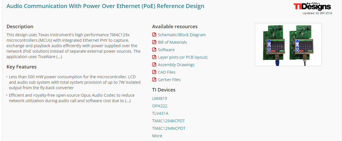

I saw TI Design "TIDM-TM4C129POE".
Circuit diagrams, BOM, etc. were listed, but I could not confirm the Tiva-C's Sample Program.
Is not this sample program open to the public?
Takashi
  • Hi Takashi-san,
     There is no SW associated with this design as nothing is required from a SW perspective. The standard examples from TivaWare can work as is after taking care of some pin mapping changes as specified in the User Guide.
     If you are interested there is another Audio POE example that comes with software example.
