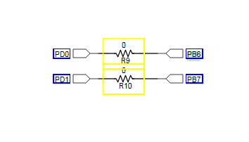

  • Are you using the EK-TM4C123GXL launchpad? Did you remove R9 and R10? By default PD0 is connected to PB6 and PD1 is connected to PB7 on the board. The schematic is on page 20 of http://www.ti.com/lit/ug/spmu296/spmu296.pdf
  • Note that such "obscure caution" does appear - w/minimal effectiveness - as its neither highlighted or colored - thus "well camouflaged."
    Packaging those "Plague-Istors" (in a small bag) - for the "very few" who (may) use them - surely trumps, "Another Lemming Over the Cliff!"
    None of this, "Your doing" - yet outsiders have identified and "squawked about this unwise design choice" for years - to, "No fix whatsoever!"

    Changed  what?     Both of your earlier selected SPI Ports - (Ports "B & D") were "plagued" by those 0Ω resistors.        Thus changing "one Port" does nothing to negate the "short-circuit impact" of those resistors!     Have you not (now) connected Port A (SPI_0) to (both) "Ports B & D" - courtesy of those delightful, (cast in concrete) "Plague-Istors?"
    You were advised to, "Pull those resistors" - so that they could no longer inflict their harm...     You are silent as regards performing that (minor) surgery...    (I would "tombstone" them.   Stand them up - soldering just one lead - as a reminder that you've FIXED your LPad!)       Once that's achieved - you may employ Ports B & D - as you originally intended...

  • I see. As far as I can understand, those shortened pins only preventing me using both of them for two different IO peripherals, isn't that true? So, I used ports A 2-5 for SSI0 and ports b 4-7 for SSI2.
    Anyway, I've added the following code to unlock those pins (port D was enabled as well):
    HWREG(GPIO_PORTD_BASE+GPIO_O_LOCK) = GPIO_LOCK_KEY;
    HWREG(GPIO_PORTD_BASE+GPIO_O_CR) |= (GPIO_PIN_7 | GPIO_PIN_6);
    still does the same, first byte is written correctly, then nothing is neither received nor transmitted.
    I believe yours to be an "overly optimistic" assessment - follows why.     Ports B & D are "joined at the hip" until you REMOVE those "Plauge-Istors!"    Any signal - introduced to/from "PB6 & PB7" - route equally to PD0/PD1.     That introduces an "unacceptable" element of risk - and extends FAR beyond the "claim" of different peripherals.

  • It is not too difficult for (most) here - by working slowly/carefully - to "heat & remove" both R9/R10 (aka "Plague-Istors"). Enough of our clients have been impaled by "avoiding that simple effort" - thus I offer up the benefit of (substantial) directly related experience.
