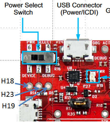

  • Also, just to add, I am a bit confused about the schematic. For host config,, I need to short H18 and H19 and it works. But according to the schematic, regardless of where the slider is positioned, the ICDIVbus is always shorted to USBVbus, which means you get 5V there all the time. But this is not the case in the Launchpad, where you only get 5V when the slider is positioned to device. Is this a print error or am I missing something?
    Thanks again
    AJ

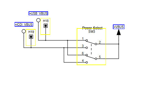

  • Here is a snip from the schematic on page 21 of http://www.ti.com/lit/ug/spmu296/spmu296.pdf.
    The slide switch connects ICDI VBUS or +USB VBUS to +VBUS, but does not connect ICDI VBUS to +USB VBUS. It is a little confusing as we used a double pole double throw switch, but wired it as a single pole double throw function.

    Thanks for the response. According to some forums, for USB host to work, I need to short H19 and H18. Looking at the switch diagram, by shorting the two, regardless of what the position of the switch is, the 5V will always drop on USBVBUS unless H18 is located on the right of pin 2. Any thoughts on this one?
    AJ
  • I forgot to add, on the Launchpad, this isn't the case. The 5V only drops when the slider is set to device and 0V on USBVBUS when set to debug, which makes it look like H18 is located on the right of pin 2..
  • OK, I understand. You want to power +USB VBUS from ICDI VBUS by shorting H18 with H19. Since they are not labeled on the board, how did you identify H18 and H19?  To me it looks like they are this way:

  • Hi Bob, cb1,
    I found the locations of H18 and H19 on the first link below. The other links are other forums I looked at. I wanted to sort this out just to rule out that I might have shorted the wrong pins, which might be causing my problem. Or probably this is completely not related. Nevertheless, I want to be completely sure my hardware set up is correct. I shorted the middle and the right hole, that is according to the link below.

  • If you shorted the middle hole to the right hole, that shorts H23 to H19. That explains why you must have the switch in the "Device" position to connect ICDI VBUS to +USB VBUS.
  • Hi Bob,
    Actually, I get 5V on USBVBUS when in "device" position and 0V on USBVBUS when in "debug" position. My set up seems to work okay. But I feel uncomfortable of the fact that the schematic doesn't match what i'm seeing on my Launchpad. According to the suggested answer on the first link, he said short the two holes above R14. Seems to me like it's a print error on the schematic.
    AJ
  • I don't think the schematic is wrong. It is just that the board does not indicate the test points or pin 1 of the switch. I think I have the switch rotated in my understanding. Give me about 30 minutes and I will update the pictures above also showing the pin numbers of the switch.
  • OK, I have corrected the labels on my pictures. Does it make sense now?
  • Pardon again - if I may - we have ohm'ed out 3 such "123 basic LPads" and report these findings:    (with regard to Power Switch positions)
    • In Debug: "H23 shorts to H19."       (middle pin shorts to rightmost pin - right-side up - looking down on the board)
    • In Device: "H23 shorts to H18."     (middle pin shorts to leftmost pin - (same conditions as above))
    That middle pin (H23) receives the bulk of the switch action.    (we've tested such across 3 of the "EK-TM4C123 boards" (fresh from our virgin stock)

  • I updated the pictures in the previous responses to avoid someone looking at the wrong picture later.

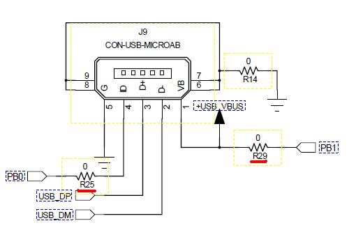

    [edit] 20 Dec 08:03:   Now have accessed the LPad's schematic - Pg. 20 (top, center) reveals "J9 as the Flash Drive Socket" (left side of the pcb) and its pin 4 (ID) as the "likely source" of "Flash Drive's Presence!     (that socket pin is routed to User's PB0)       Simple "monitoring" of PB0 - w/and w/out Drive Inserted - should enable the recognition of such "Drive's Presence."      Yet I am "compelled to comment upon PB0's being allowed to "float" - which (likely) enforces the requirement of an "internal MCU pull (up or down) resistor" to prevent "PB0's read confusion."
    Lastly - no mention has yet been made of the USB socket labeled, "Device."      I assume that this "Device socket" powers & connects the Flash Drive via a suitable USB cable.     (and that cable must supply the relatively large, flash drive's mating (plug-in) connector - and then translate that to the far smaller, 5 pin USB connector resident upon the LPad.
    Is such a cable a "standard?"     If so - might someone here suggest a "Cable Part Number?"    The cable may be described as USB "A" female to USB "B" micro Plug.      Firm/I have over 10 different USB cables & adapters - yet none enable a short connection between "USB Flash Drive and the LPad's micro B receptacle!"      Again - how is this connection challenge normally handled?
    If not "standard" - might "AJ's" difficulty be the result of a "failed cable hack?"     (which "swallowed" the Pin 4 (ID)'s presence signal)
    Thanks Bob for the detail and also for "exercising the LPad" so that a positive verification of  "Flash Drive's Presence" was achieved...   Very much appreciated.       (and hopefully exploited by users AJ & cb1...)

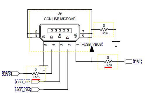

  • If I may - to add a "bit more fire" to this thread's flame - appears now a snip from 123's LPad, Pg. 20:
    Do note (both) R25 & R29 (in highlight).       Now J9 is the "Device USB receptacle" - and it must be noted that upon "all three" of our new/unused "123 LPads (EK-TM4C123)" - both resistors are ABSENT!
    Thus - if  PB0 is to signal the "Presence" of a USB Drive - the unmodified LPad appears to FAIL in that "Presence Detect" regard!          Note that the "instruction to add (insert) those 2 resistors" does appear w/in the LPad's manual - yet it suggests their use is "limited to adding OTG functionality."        (it seems reasonable that "Presence Detection" extends (beyond) OTG and OTG only - does it not?)

  • Good for you.   May we ask - have you added R25 (presence detect) and/or R29?      Both (absent) on 3/3 of our unused, '123 LPads.
    Schematic (1 or 2 (of my) posts up) documents such requirement...     And again - "Plague-Istors" should be "yanked" to prevent future mischief!
  • Hi cb1,
    I copied this from the link I posted somewhere in the beginning of this forum,
    Here are the hardware changes I made
    1- Under the power switch there is three holes, you have to connect the ones above R14 and move the switch towards the device mode, you can use a wire but I did soldering for a fixed solution.
    2- Populate 0-ohm resistors on R25 and R29 that are next to the USB connector, in my case I did normal soldering and it was fine.
  • Good - schematic did demand the presence of both R25 & R29 (for drive detection) - your confirmation adds confidence. Mercî.
