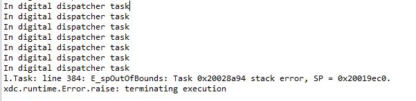

I have configured 32 bit timer 5 as shown below,

TimerEnable (TIMER5_BASE, TIMER_A);
Inside ISR handler, I have cleared the timer interrupt. I have set stack size 15KB in .cfg file.
Program.stack = 15360;
My program is getting terminated after turning on the timer showing stack out of bounds. The console window is as shown below,

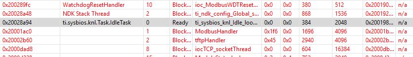

The debug window is as shown below,
The task detail from ROV is attached below,

  • Hi Sandra,
    You cannot call TimerIntRegister in a TI-RTOS based application. For a detail look at what happens, take a look at the last post on this thread: e2e.ti.com/.../2347913
    It's a different device, but the driverlib's IntRegister() function is similar.
    You can use the Timer module in the TI-RTOS kernel to configure your timer instead. Or you can use the Clock module if the period you want is a multiple of the Clock's period (which is 1ms by default on your device).
