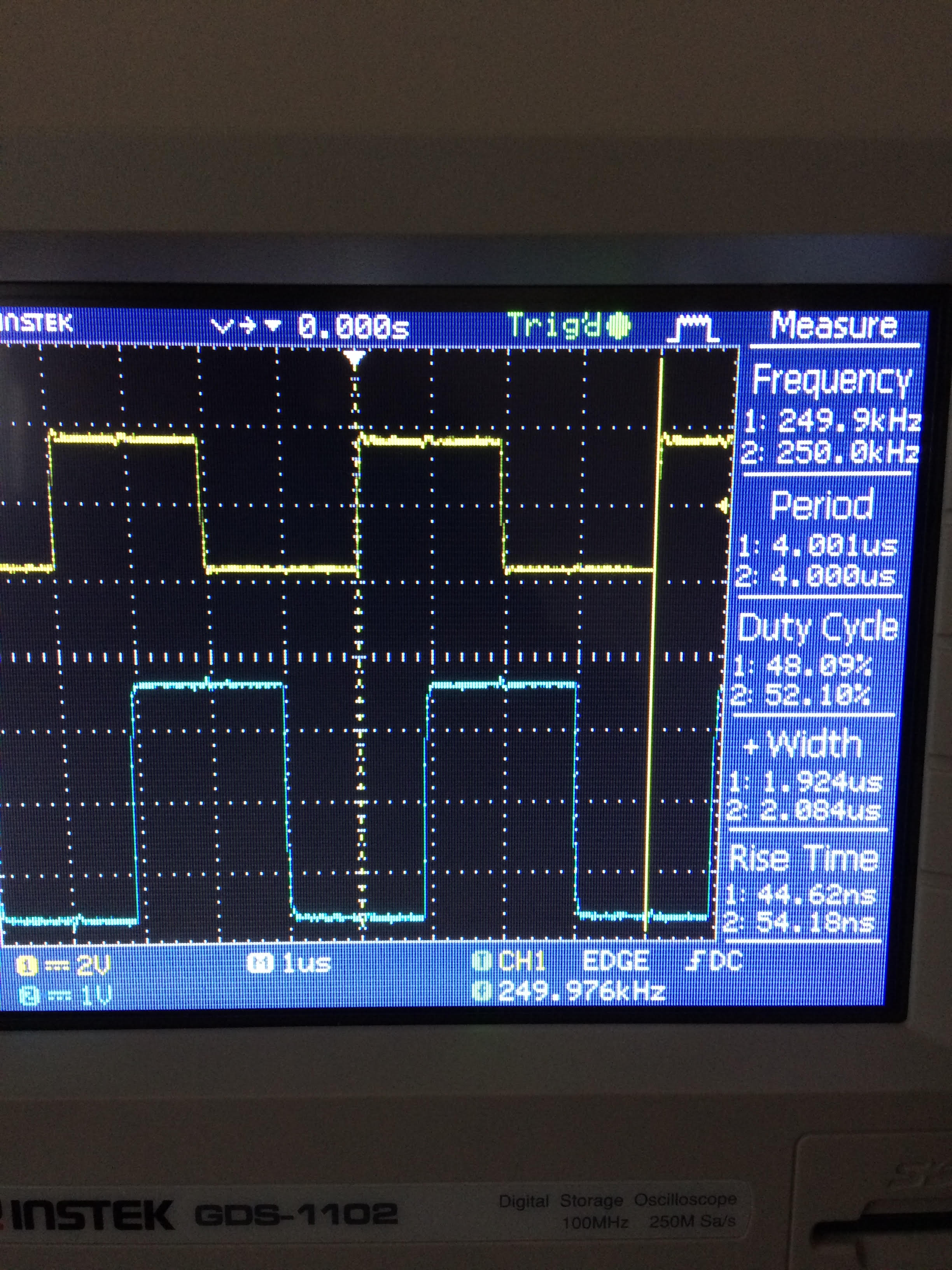

How can I produce a deadtime that will be 20 percent of the pwm period ?
where do i make mistakes ?

PWMDeadBandEnable(PWM0_BASE,PWM_GEN_2,deadband,0); // pd1
//PWMDeadBandEnable(PWM1_BASE,PWM_GEN_0,deadband,0); // pe4
PWMOutputState(PWM0_BASE, PWM_OUT_4_BIT,true);
PWMOutputState(PWM0_BASE, PWM_OUT_5_BIT,false);

  • Note too that there "ARE LIMITS" upon the amount of "dead-time" which may be imposed.       (the API's PDL exposes those limits - enforced by the "dead-time" function.)
    It (may) prove possible to "roll your own function" - to "defeat" (at least extend those limits) - you assume all risk if you elect that method.        (see my "Providers of Content" boilerplate - at the base of each forum page...)

       ASSERT(ui16Rise < 4096);   //   thus 4096/65535 = 6.25%  ...  suggests  "maximum dead-band as % of pulse width"   (does not consider the "fold-back" nature of "dead-band")
       ASSERT(ui16Fall < 4096);
    Depending upon poster's PWM Frequency - the unusual magnitude of his (desired) deadband - may not enable such a setting!     (without skillful & repeated, "machete use" ...  to "hack the example code..."
  • And even bigger issue may exist in the PWMCLK  being 2Mhz even capable to produce any desired machete hack of example project.
    Besides poster requires 20% of said PWM period = DB, is such an edge time even possible (2000000 / 250000 = 8 ticks) or (500ns / 4us = 125ms) tick period. The 16Mhz CPU clock / 8 = 2Mhz PWMCLK, seems a bit slow for producing such a high PWM frequency and adding 200-300ns (typical) DB time into each PWM period. Code below assumes (deadband)=125*20=2500 and (cycle)=125ms*50=6250. Yet the decimal point (0.125) is missing in my example, factoring by posters actual tick periods we get 2.5 and 6.25 relatively. Perhaps move PWMCLK decimal point, increase tick period a relative factor of 10, move it 6 places to the left gives 60Mhz PWMCLK, that even seems a bit slow in my gut if poster desires 249-250kHz (fixed) PWM frequency. What is posters desired min/max Ton/Toff periods, we have to assume an inverter with dead band in the mix and does the PWM duty cycle change relative to actual inverter load.
    Who knows what the posters desired PWM frequency even is, that has not been clarified other than poster providing a signal capture of what exactly!

  • Note you were spot on (2.5%/6.25%) agrees with an actual PWM math equation. Do you have any advise to poster as what might be a minimum PWMCLK needed to achieve (assume 250kHz PWM frequency) prior to adding dead time into a PWM period.
    Is there not a factor or multiplier recommended in the TM4C129x datasheet as to what the PWMCLK must be relative to the smallest desired PWM period. Perhaps other TI forums datasheets go into great detail in this area. TI seminar video training could be more relative in the long run at very high PWM frequency. Past Tivaware DB example was not written for TM4C129x processor and required many tweaks just to get it running.

  • Your desire for 20% Dead Band proves unusual - it is a very high value for dead-band.
    The frequency of your PWM signal - especially should it be (relatively) low - may yield "excessive dead-band time periods!"
    Why do you believe you require a 20% dead-band?     From where did that idea originate?
    The purpose of dead-band is to attempt to minimize any (near) simultaneous conduction of (both) your (likely) High and Low Side Power Devices (FETs usually) - a condition called "Shoot-Through" - which usually (if not quickly & forcefully limited) results in the destruction of  your Power Stage!      (and too - your pcb - should you be especially unlucky)

    To my surprise the GaN seminar (link above) scope captures show DB delay near 1.7ns, WOW. Seems to indicate a highly efficient PWM system possible with GaN. The TI GaN module kit can quickly launch a beginner to understanding how DB delay effects overall inverter efficiency. Besides that forum users can connect kit onto most any launch pad and capture 1/2 bridge DB delay results. Seemingly It is most difficult to capture high frequency DB delay produced by (one) generator without a 1/2 bridge and scope probe connections.
    Pardon - but have I not "Done exactly that" (capture "HF" (yet undefined, here) Dead-Band imposed upon one PWM Generator's dual outputs - and (completely) ABSENT any "half-bridge?"     I've posted such - right here - more than once - year or so back...
    Obviously - with 2 channel scope probes connected.   (that point (somehow) escapes me.)

  • GaN video uses a function generator to develop 2.0ns Rise and 1.7ns Fall DB delays, mistaken 12ns.

  • LMG5200 (12ns/1.7ns) DB delay seems to occur inside the GaN driver, perhaps poster discovered DB is built into LMG5200 GaN switch. Honestly I totally missed that the first few times watching video.
