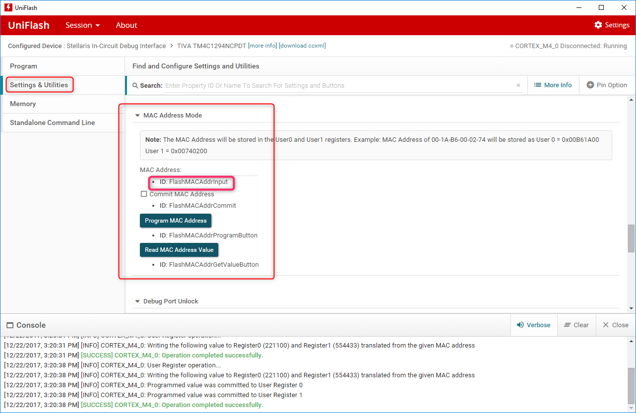

I'm using the latest version of UniFlash for Linux and am able to flash firmware fine and dandy but would like to know how to program the MAC address into user flash registers through the command line as well. I currently use this command to program the application:
$sudo ./dslite.sh -f --config=tm4c1294ncpdt.ccxml -e ~/smartsense-bsp/Tiva/engineering/build/va.out
I found a similar post but it seems to be for an older version of UniFlash and the additional options for programming MACs do not work.
