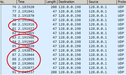

I use TM4C1294NCPDT chip in my Ethernet application. When I send  several(15) short(47 bytes) frames with a high frame's frequency (10-14 uSec between frames) from Host computer to my controller, the controller misses some frames.
When I decrease frames frequency(make a little delay between the packets) the controller doesn't miss the frames.
I found, that frames are missed when they are moved from RX FIFO of Ethernet controller to RAM, by Ethernet's DMA. ("Missed Frame Counter" bits of EMACMFBOC register increases when I send these packets).

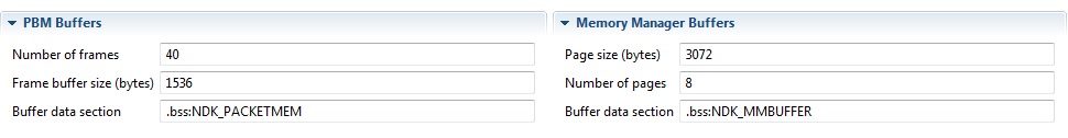

  • Additionally, what are your memory settings for the NDK? Can you try increasing the number of network buffers? For a detail description, please refer to this site: processors.wiki.ti.com/.../TI-RTOS_Networking_Stack_Memory_Usage

    I tried to increase the number of buffers and it didn't help.
    It does not look like there are not enough buffers or overflow, because it only receives 15 short UDP packets.

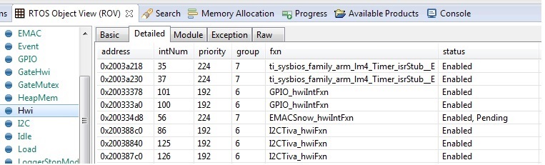

  • What are the priority of the interrupts in the system? You can see it with Tools->ROV->Hwi->Detailed in CCS.

  • Hi Todd.
    I removed from the application all things that I can. The result is the same, missed frames. Here is the remaining Hwi.
    I2C interrupts – send data to leds and faders, GPIO – receive data from switches.
