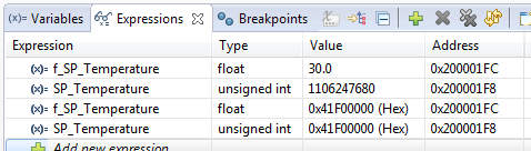

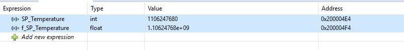

I am using TM4C129ENCPDT controller and the IDE is CCS Version: 7.4.0.00015, recently facing an issue with reading a 32 bit unsigned integer to a float variable. have tried type casting too, but unfortunately it is not working.
for example, consider the value 30.00 as in integer representation.
SP_Temperature = 0x41f00000; // 32 bit unsigned integer >> 30.00
f_SP_Temperature = (float) SP_Temperature;   // f_SP_Temperature >> float, SP_Temperature >> unsigned 32 bit integer
The value of "f_SP_Temperature" is taking as decimal equivalent like "1.10624768e+09"
Please find attached screenshot of the same, any help is highly appreciated.
  • Hi Kurian,
    Can you please elaborate the problem? 0x41F00000 is equal to 110624768 in decimal. What do you expect the f_SP_Temperature to be?

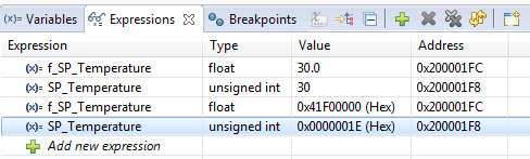

  • I think you are trying to do something like this:
    float main(void)
    	uint32_t SP_Temperature;
    	float f_SP_Temperature;
    	SP_Temperature = 30; // 32 bit unsigned integer >> 30.00
    	return f_SP_Temperature;
    Then if you look at  the variables, you can see the hex representation of a floating point 30.0 is 0x41F00000.
  • Thanks Bob. The poster just needs to right click on the expression window and under the Number Format, select the hex.

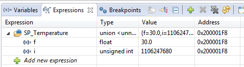

  • Sorry, I just could not resist one more comment. Perhaps a more elegant method would be the use of a union. Basically telling the compiler I want to reference a single location two different ways. It would look like this:
    float main(void)
    	union
    		float 	  f;
    		uint32_t  i;
    	}SP_Temperature;
    	SP_Temperature.i = 0x41F00000; // 32 bit unsigned integer >> 30.00
    	return SP_Temperature.f;
