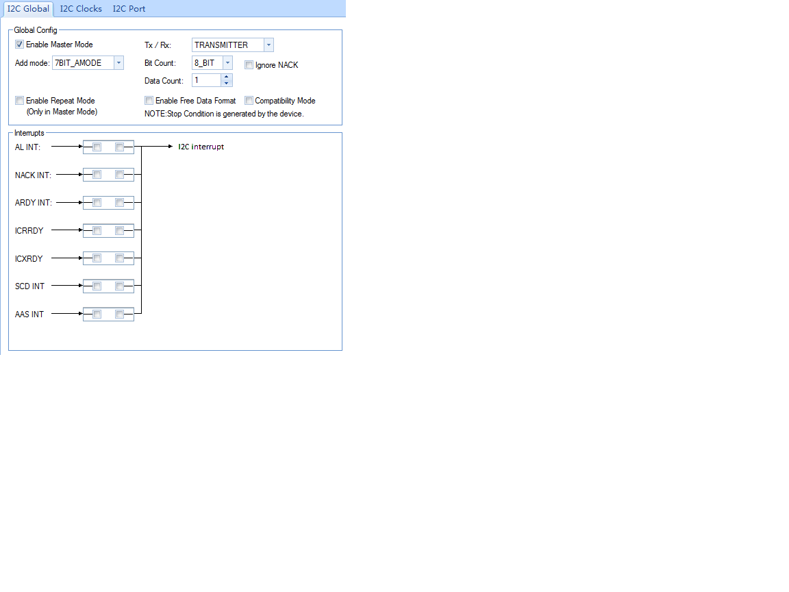

hi,
I'm using the  RM57L84x as the I2C master, communicating with an I2C peripheral that operates at 100kHz.
it works well at most of time,but occasionally the RM57L84x can‘t output SCL(clk)。When this phenomenon
appears,I check  the Tx data has been already loaded into  the Tx register I2CDXR。Power off the RM57L84x
for a while, the communication turn to normal. My i2c driver code is generated by HALCoGen 04.06.01。
the code is as follows:

  • Hello User,
