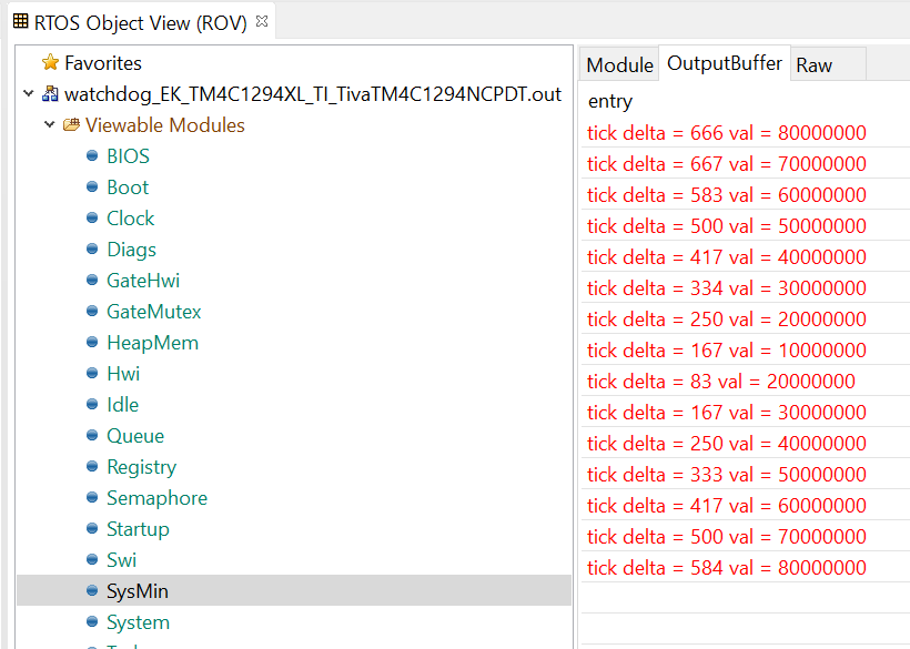

    I modified the Watchdog example in TI-RTOS. I changed the watchdogCallback to this
    #include <ti/sysbios/knl/Clock.h>
    void watchdogCallback(uintptr_t unused)
       static int tick = 0;
       static int prevTick = 0;
       static int reloadVal = 90000000;
       static int delta    = -10000000;
       reloadVal += delta;
       if (reloadVal <= 10000000) {
           delta = 10000000;
       prevTick = tick;
       tick = Clock_getTicks();
       System_printf("tick delta = %d val = %d\n", tick - prevTick, reloadVal);
       /* Clear watchdog interrupt flag */
       Watchdog_setReload(watchdogHandle, reloadVal);
       Watchdog_clear(watchdogHandle);
       GPIO_toggle(Board_LED0);
    I also bumped the SysMin.bufSize to 1024 in the .cfg file. Try running this and then halt it and look at SysMin in ROV. You can see that the tick count is changing accordingly.
    You can also see the change in the LED toggling.
    What you are doing should be fine. What value are you using? Are you calling Watchdog_clear in the callback function?
    Todd
