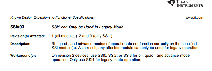

and have tried everything suggested in that thread to the best of my knowledge, and also referred to the errata which said to do this:
Here is my initialization code:

// From errata: SSI must be initialized with SSICR1.EOT bit clear.
HWREG(SSI1_BASE + SSI_O_CR1) &= ~(SSI_CR1_EOT);
