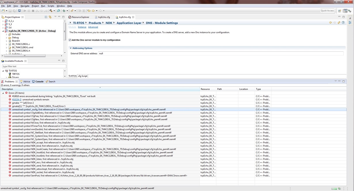

I would like to resolve hostname to ip using local DNS server. ( Sometimes valid DNS servers are used such as dnsmasq, sometimes a basic router does the job with static dns entries.) My problem is I don't find any out of the box examples nowhere.
My starting application is the tcpEcho example (EK-TM4C129EXL) and I only add the DNS module to the config. After that I can not build the example. Can you tell me how to go on?
Please see the attached image:
Looking forward you kind reply,
  • Daniel,
    You can use DNSGetHostByName() (which is similar to gethostbyname()). What you are did was add a DNS server into the target. I don't think you want to do that. You want to access a local DNS to resolve the name. Note: the DNS servers are specified as part of the DHCP setup or must be explicitly set if you have a static IP address.
