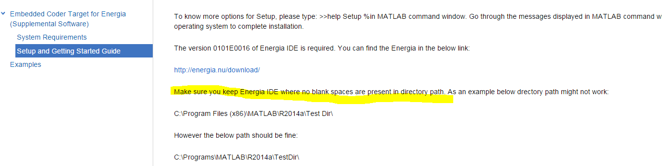

Hey all, I have a problem linking tiva with matlab I have followed the steps on mathworks forum and every time I generate the default model I get this error :
'C:/Program' is not recognized as an internal or external command,
operable program or batch file.
gmake: * [Tawfiks.o] Error 1
### Creating HTML report file Tawfiks_codegen_rpt.html
### Build procedure for model: 'Tawfiks' aborted due to an error.
Error(s) encountered while building "Tawfiks":
### Failed to generate all binary outputs.
Any idea how to solve it ? thanks in advance
