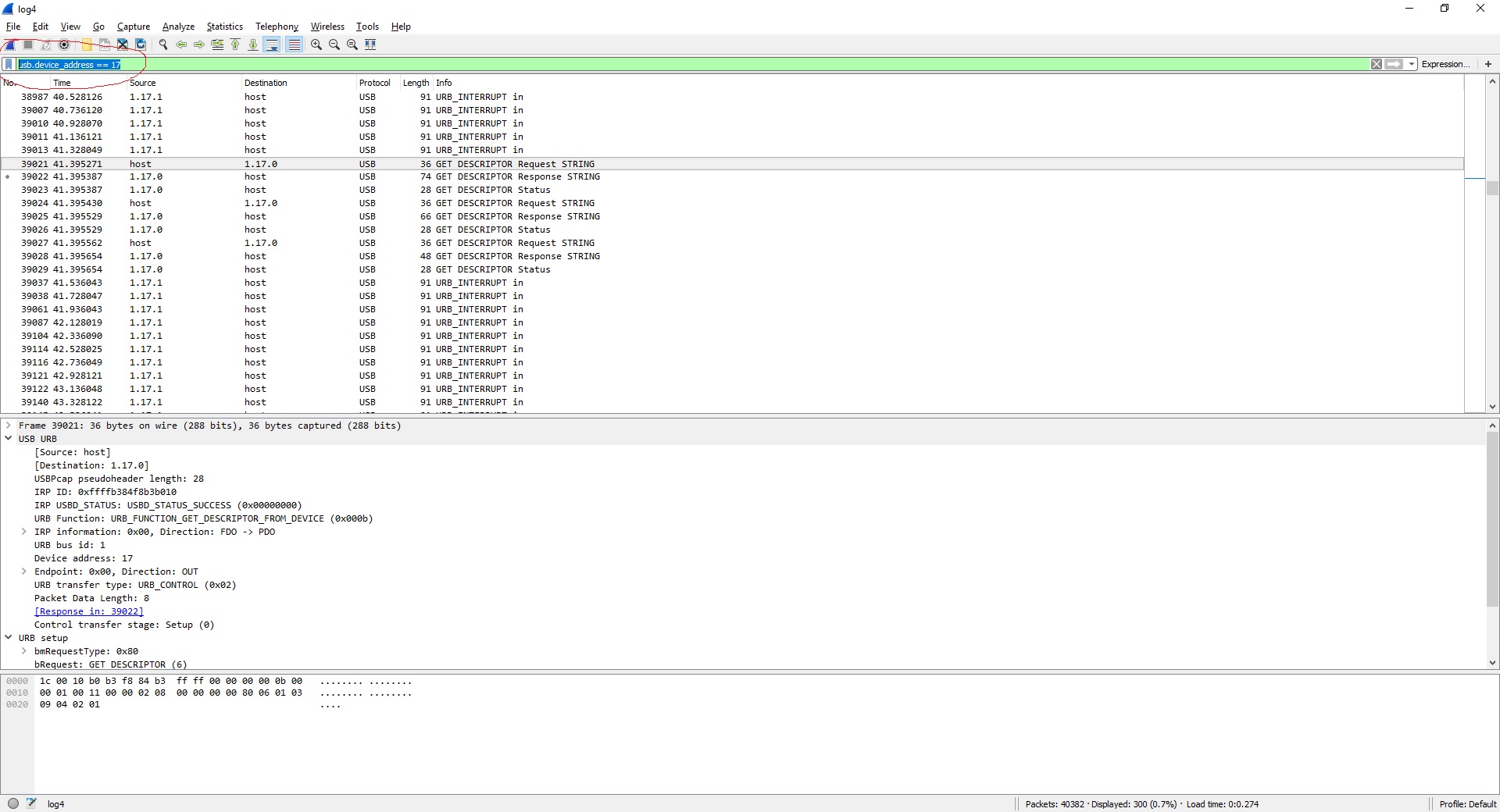

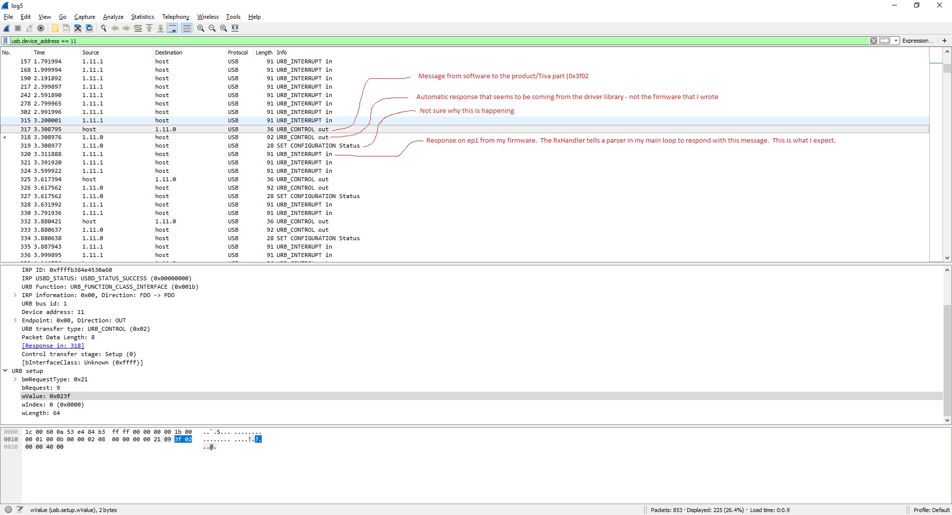

  • Ralph,
    Thank you for updating the title and thanks for the reply!
    This is the source I was looking for.  It seems to make sense though.  Per TI's documentation, when I send a message over endpoint 0 I should see an interrupt on my callback with this event type USBD_HID_EVENT_GET_REPORT_BUFFER.  Once this happens I should immediately see my RxHandler get called again with this event USBD_HID_EVENT_SET_REPORT.  I believe the code you found is the code that calls my RxHandler the second time to return the data in endpoint 0.  I will spend some more time digging into usbhid.c and see if I can make some more progress.
    In the mean time I logged the traffic on the USB hub the Tiva part is connected too.  I have one Tiva running version1.x of the USB driver library.  I have a second devie that is the same hardware design, but running the updated driver library 2.1.4.178.  I have attached the two logs in case you want to check them out.  I dont' know if they uploaded correctly.  I tried the paper clip link, but they were inserted with huge folder images.
    Log4.pcap
    log4.zip
    Log5.pcap
    log5.zip
    Anyways, you can open those log files up in wire shark and see the traffic.  In the filter section you can use the usb.device_address == 11 for log5 to get rid of all the other traffic and see the traffic from the working device.  Log5 is the setup that works fine and the usb link never crashes.  The device sends a message back to software/PC constantly that is a 0x3f08.....packet.  This is irrelevant.  The relevant packet starts with 0x3f02.  The message works as follows:
    Software sends a 0x3f02 packet to the tiva part.  The tiva part is supposed to respond with a 0x3f02 [bytes of data] on endpoint 1.  This is a response from my main software loop in the Tiva part on ep1.  For some reason though, the tiva part actually responds with a 0x3f02fffffff... packet on ep0 and then the expected packet 0x3f02[data] on ep1.  With the old driver library this is consistent and works all day long.  Here is a screen shot of one of the messages in the log.
    I hope that is readable :/
    For log4 use usb.device_address == 17 as the filter option shown in screenshot below:
    Log 4 shows the device that is running the latest driverlib using the latest usb driver library.  This device has a USB link timeout after I send a couple (2-15) messages back to back.  The messages in these two examples are exactly the same.  I've noticed that there is a point where there is no automatic response on ep0 and I'm thinking that causes the USB link to lock up.
    Here is a screen shot showing the traffic and the missing ep0 response.
    When looking at the traffic with the old driverlib (v1.x) it looks like - when my software app sends the Tiva a message on ep0 the Tiva driver responds with an echo or something on that end point AND the call back works as expected allowing me to throw a flag in my RxHandler and tell my main loop to send a packet of data over ep1 in response to the message as well.
    When looking at the traffic with the latest driverlib (version number above), after a few messages the Tiva driver no longer responds on ep0 and the usb link times out.

    This problem is also not consistent regarding number of messages sent.  It changes so sometimes it fails after 2, 5, 7, 11 etc...  It does seem like spamming them faster brings the issue out faster, but I can't really verify as this is too inconsistent.
    I've attached a zip of the screenshots I inserted in case the quality is bad.
    TrafficScreenShots.zip
    I'll continue digging, but I thought maybe you guys could glean something out of the traffic and responses of the part.
    Thanks again for you support Ralph, I really appreciate it!
