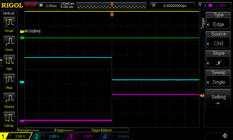

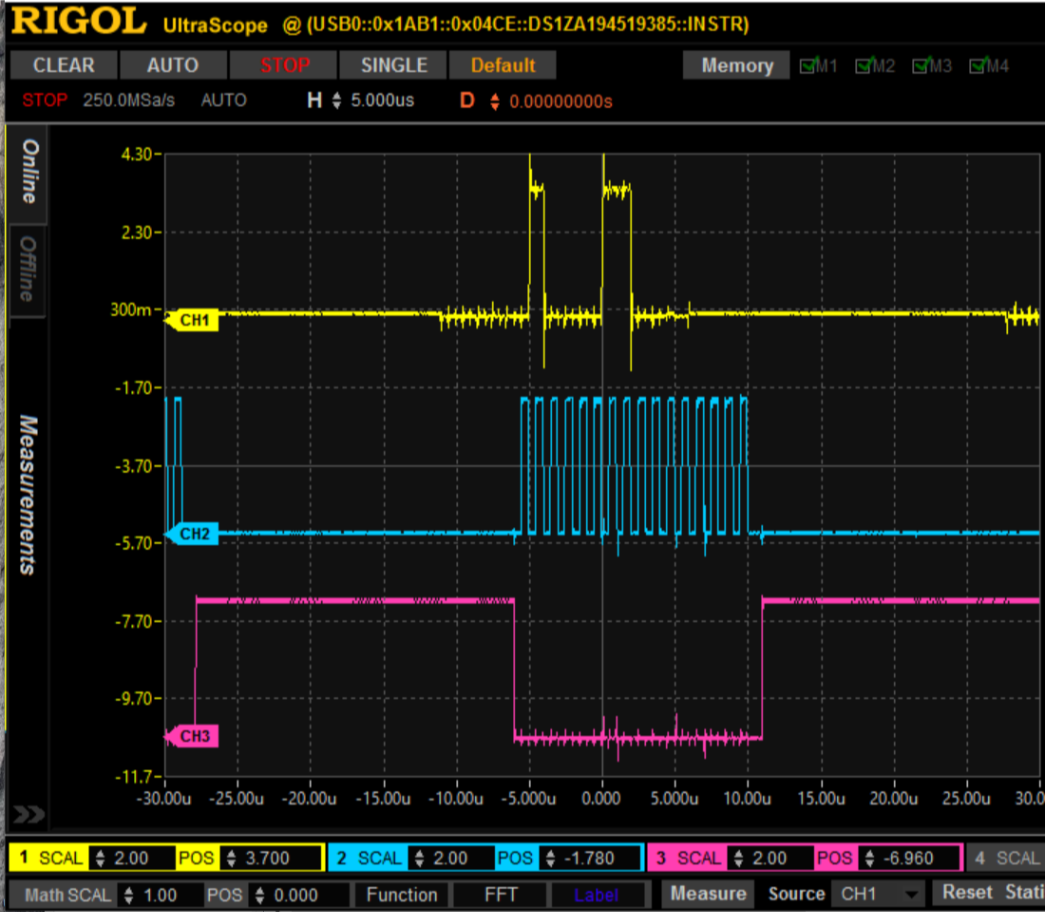

hello
i'm trying to interface MAX6675 (k-Type - digital converter ) 'doesn't require mosi'  and 'works in mode 1'
first i tried to use the tivaware examples that exists in (ti\TivaWare_C_Series-2.1.4.178\examples\peripherals\ssi)
(spi_master.c) on the transmitting works very well but in the receiving it doesn't seem to work i tried to loop the tx part and on the oscilloscope everything works fine but when tried to loop the rx part the clock is not generated and the cs is always high
i thought of trying the (soft_spi_master.c) and everything is correct on the tx and rx so what is the problem with hardware one
note: i didn't modify the code at all just using a while(1) to watch the signals on the oscilloscope
thanks
  • Hi Samir,
    What do you mean you tried to "loop the rx part"? What is the hardware setup when you run the example? Do you have your MAX6675 connected to the MCU when running the example? The MCU is the master. Even in receive mode, the MCU must generate SPICLK. In order for the master to generate clock you still need to generate the dummy write on the MOSI even if you don't need to send data to the slave. The slave can ignore the transmitted data on the MOSI. But when the slave sees the SPICLK it will return the data on the MISO back to the master.
  • yes it's always connected using ssi0 pins (PA2-PA3-PA4) with 3.3v and GND
    by loop i meant that i had receiving for loop in the example in while (1) but strangely the receiving is now working when i used the none blocking function but now another strange thing is happening the max 6675 returns always the same value unless the i re upload the code and if the board is rested it doesn't give any output
  • Is the CS (SSI0FSS) pin active low during the transmission? Please show your scope cap and also your modified code.

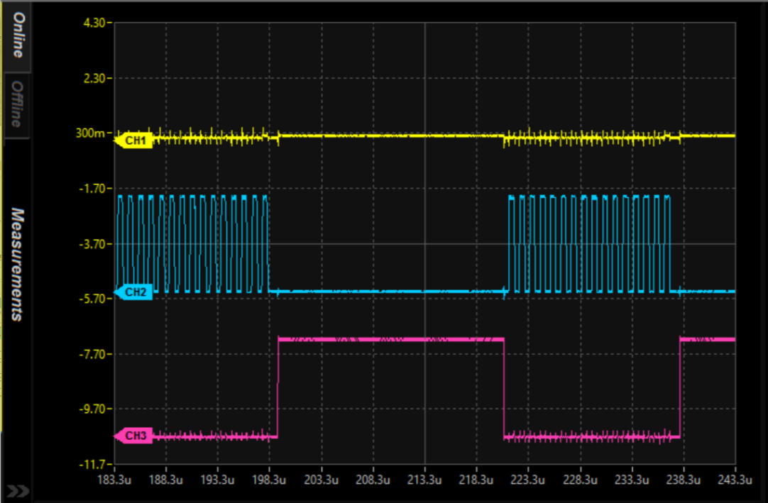

    those two images first one is after uploading the code the second one is after removing the usb and reconnecting it
  • The SPICLK and CS looks proper. There is no MISO. The MISO comes from your MAX6675. Check if there is any drive conflict on the MISO. Unconnect the MISO from the MAX6675 to the MCU. Do you still see nothing on the MISO. If this is the case then you need to investigate on the MAX6675 side. Another thing to check is if you have proper voltage level on the SPICLK and CS. I can't tell from you scope cap.
    What if you don't unconnect the usb power but just reset the device?
  • if i did only a rest i get the first image but without a change in the readings if i unplugged the usb whatever i do i t doesn't work unless i re uplod the code
    when i disconnect the MISO i get the SPIclk and cs and nothing on the MISO
    i thought the problem is in the MAX side so i tested it with arduino and worked fine
    the voltages on the oscilloscope those images are taken in 2 v/div for the three channels
  • Please take scope capture of the CS and SPICLK right after you plug back the USB power. Perhaps your MAX device may have seen some switching activities on these two signal lines after the power up. Your MAX device does not know your MCU just came out of the power up. Any activities on the CS or SPICLK may confuse the MAX device into thinking it is a valid command. One more suggestion is to add a pullup on the CS signal and do you see any difference?
  • after adding PULL UP nothing new in all
    single shoot mode at the usb plugging
  • Your delay inside the while(1) loop may be too short. You have a SysCtlDelay(200) which is much less than 0.17s. The MAX datasheet says the typical conversion time is 0.17s. If this is the case you are trying to read before the conversion is complete. Try to increase the delay (over 0.17s) and see if that makes a difference.
  • thanks Charles that solved my problem i don't know how i missed that :)
