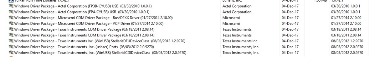

  • In addition, in the installed drivers I could see this  list above .
    Are these the proper drivers ?

    You seem to have a couple more Sterllaris related drivers than I do. Looking at the dates, I wonder if the extras were older drivers, as we did have updated drivers for Windows 10 released as a patch outside of TivaWare. The download for that is: software-dl.ti.com/.../SW-TM4C-2.1.4.178.PATCH-1.0.zip
    Looking at your device manager screenshot, what shows up under Texas Instruments Debug Probes, and Universal Serial Bus controllers?

    Recalling what you say about other drivers - what I can see in the list of drivers installed are the Stellaris from 8/3/2012 .... Do you have newer ones ? Are these at all relevant ?
    - BTW, just for my understanding, Could you please tell when these "windows _driver" elements which I have replaced are coming into action ? - I didn't see any change in the Device Manager .... neither any command line pointing to the TivaWare directory....
    - looks to me as something is still missing.
