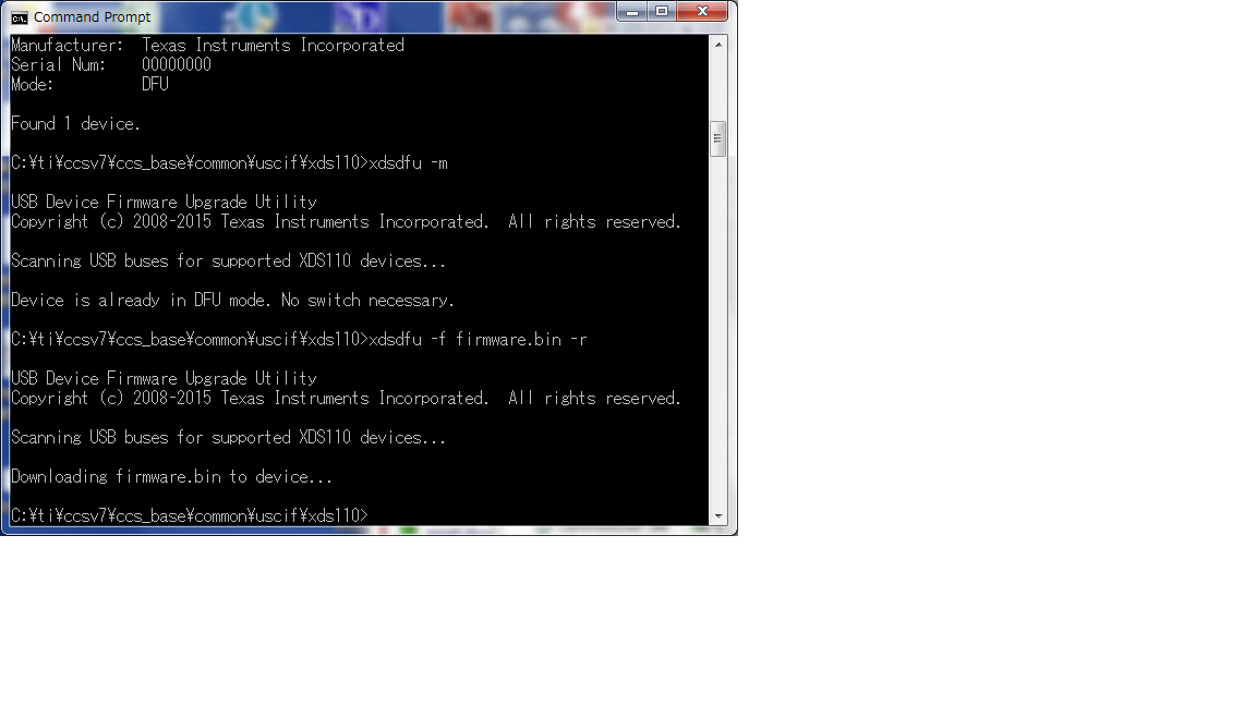

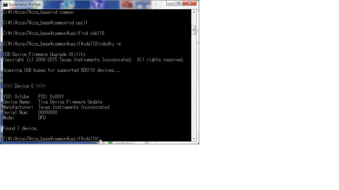

  • Hello
    It was operated by the following method..
      1.open a Windows Command Prompt.
      2. Go to the Directory
       C:\ > CD c:\ti\ccsv7\ccs_base\common\uscif\xds110
      3.execute the following on the Command Prompt.
       c:\ti\ccsv7\ccs_base\common\uscif\xds110 > xdsdfu -e
      4.execute the following on the Command Prompt.
       c:\ti\ccsv7\ccs_base\common\uscif\xds110 >xdsdfu -m
      5.Execute the following on the Command Prompt.
       C:\ti\ccsv7\ccs_base\common\uscif\xds110>xdsdfu -f firmware.bin -r

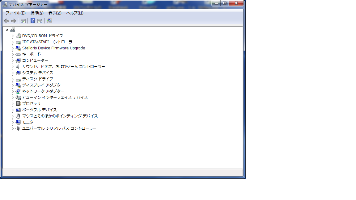

    However, xds110 does not appear in Device Manager.

  • Iwao,
    Thanks for sending the detailed information.
    You performed the process correctly, but I have one comment: can you try to unplug and re-plug your board after the last command?
    Sometimes Windows does not pick up the changes unless the board is disconnected from the USB port.
    If that does not work - i.e., the Control Panel always shows the 'Stellaris Device Firmware Upgrade" entry (also called DFU), then your board is not working properly. I would contact your distributor and evaluate what can be done to repair or replace the board (if under warranty)
