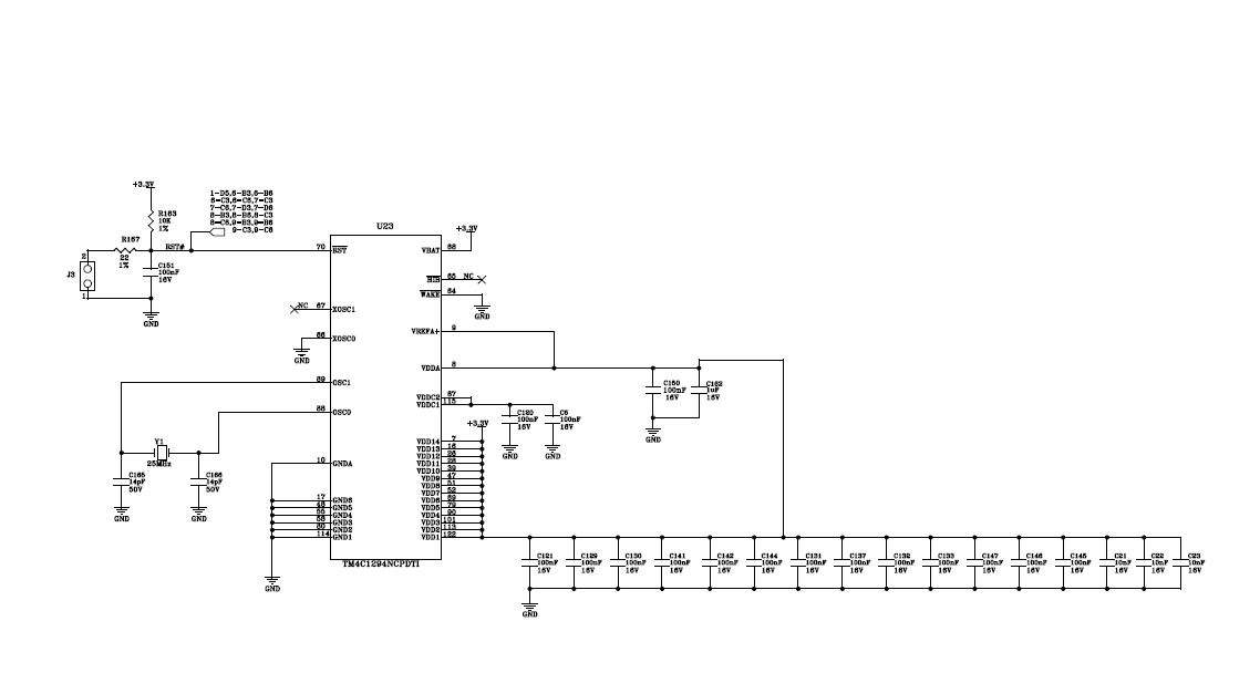

Both boards us Artesyn DC-DC POL 12V / 3.3V converter for VDD, 3A capable unit..

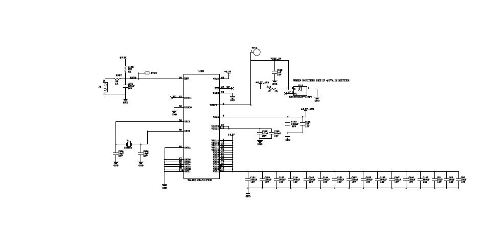

The one that seems to work without problems has a separately derived VDDA, made from the external 12V power supply run via an isolated POL, and then a 5V LDO, and then a 3.3V LDO. (I do have a diode between VDD and VDDA in case the chip wants to lock up).
The one that has problems has the same 3.3V bus going to both VDD and VDDA, which is nothing unusual.
I decided to short the two voltages in the board that works (where the voltages are derived independently) and it started exhibiting exact same problem.
The rest of the board seems to work, the code runs fine until the CAN communication occurs at which point it signals an error.
This problem only occurs after a power-cycling: initially, when the board is programmed via the debugger without power cycling, it works fine.
In the Application Report SPMA056–October 2013, the "System Design Guidelines for the TM4C129x Family of Tiva™ C Series Microcontrollers ", I have this which I am not sure I fully understood:
3.4.1 Microcontroller Power Supply.
"The supply connected to VDD must accommodate a short period (40μSec to 60μSec) of additional inrush
current that occurs as the decoupling capacitors connected to the LDO on the VDDC rail charge up to the
VDDC voltage level. Internal circuitry limits the inrush to the IINRUSH(max) specified in the data sheet for the
part. The supply connected to VDD can self limit the current it supplies to something less than the
maximum IINRUSH, however that extends the period it takes to bring VDDC up to operating voltage."

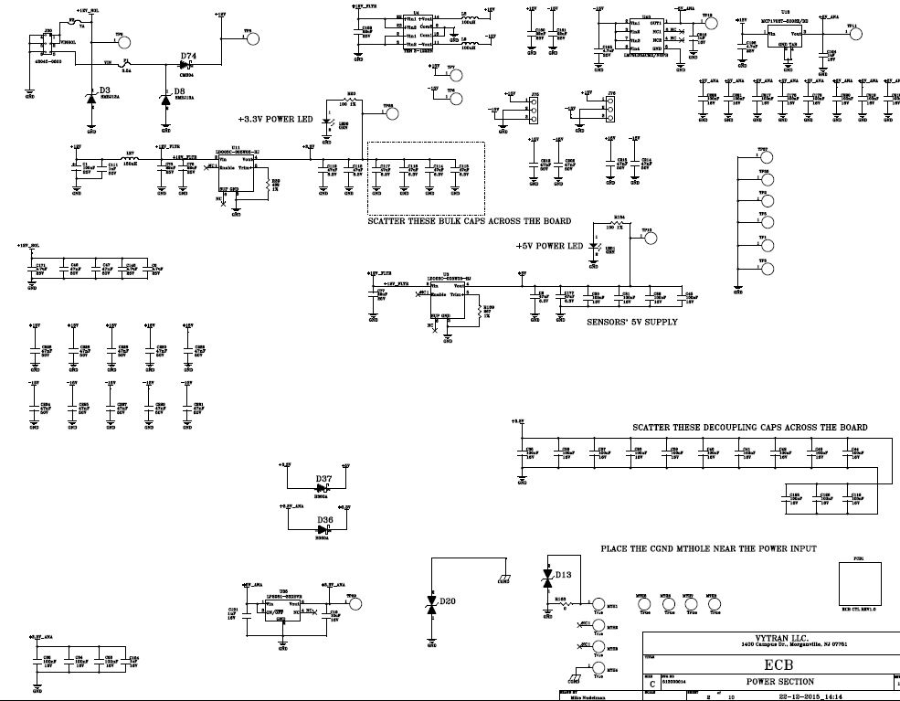

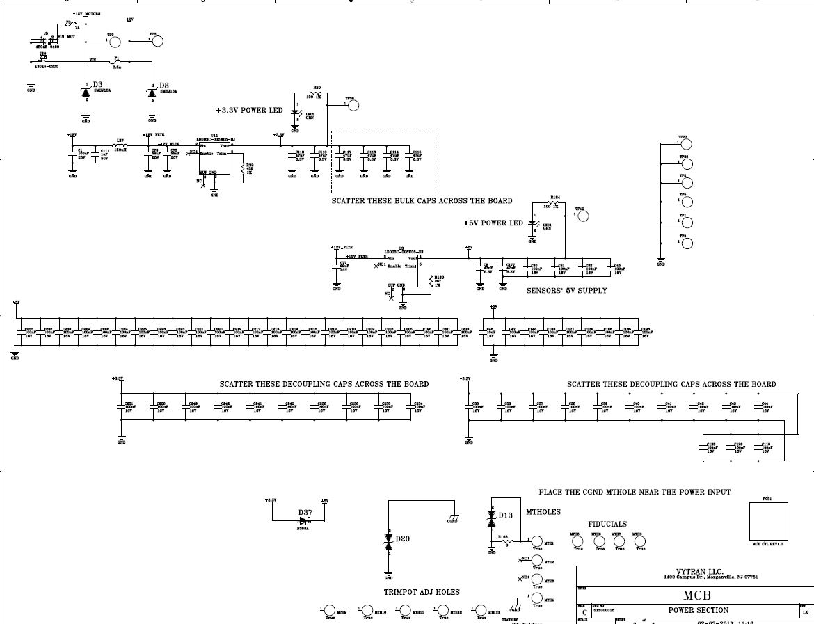

This is the setup of the board with the same VDD/AVDD.
This is the setup with separate VDD/AVDD

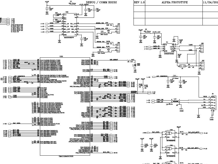

  • Interesting. What type of CAN transceivers are you using and how are they powered? What is of particular concern is how the power for the micro side of the transceiver relates to the TM4C1294 VDD. You might want to look at the CAN RX line with a scope on the failing configuration to see the signal levels and if the signal follows CANL. Can you look at the CAN status register and tell what kind of error occurred from the LEC (last error code) bits?
  • Bob
    Thanks for looking at it.
    The transceiver is SN65HVD233D, shown in the upper right corner below. Powered by the same voltage as the VDD (that is directly tied to it through a ferrite).
    The signal levels are fine, both TTL and the CAN H/L.
    Again, the two boards has exact same arrangement in that respect. If the two "good" boards (with separate VDD and VDDA) are programmed with the respective codes for the "good" and "bad" boards (they have different functionality but nearly identical core including CAN interface that I showed in the previous post), everything works fine then.
    If a "good" board has its VDDA and VDD tied together, it becomes "bad" and the CAN fails.
    Mike.

  • This is puzzling. We have used the SN65HVD233D with VDD tied to VDDA on the TM4C1294 before with no issues. Were you able to get the failure type from the LEC bits?

    As to the VDD vs VDDA timing: they are the same bus, +3.3V in my sch, and physically are one extremely low inductance wide power plane. I am not sure how it is physically possible to have a timing issue here.

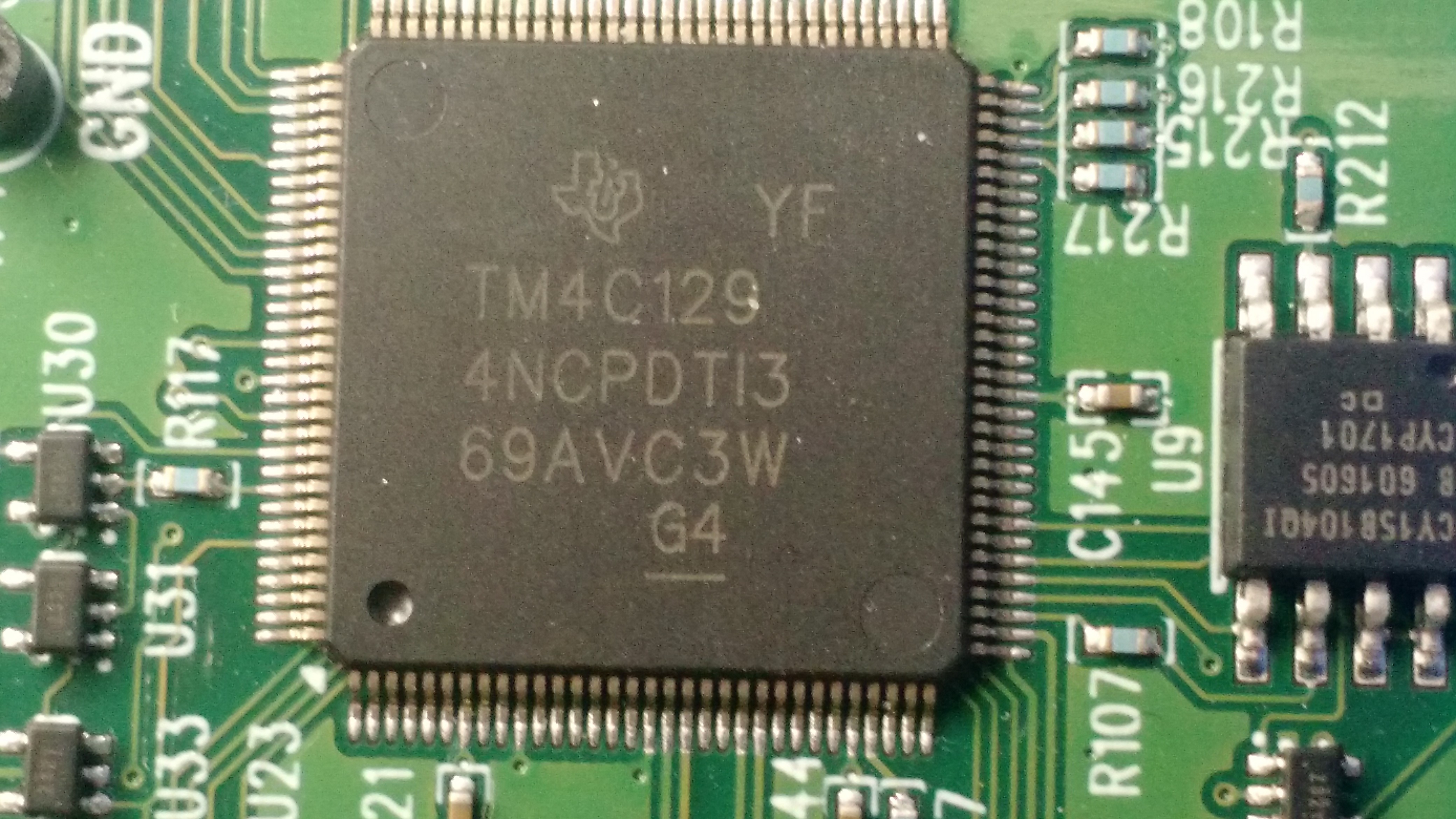

    Anyway, the chip version - see the pic below.

    Even a "near blind squirrel" (seen around these parts ... I am told) could read the chip markings (Ver) from that neat photo!    (might your camera lens - or God forbid - your MCU - need "blast of air?")

  • That is the latest version of the silicon.
  • Thanks for that.
    And - any (near) similar (client issue) "Errata" is "not expected" under this "latest/greatest" silicon - is that true?
    To be complete - we should confirm that "each/every" (failing) MCU is as marked - as the photo revealed - should we not?

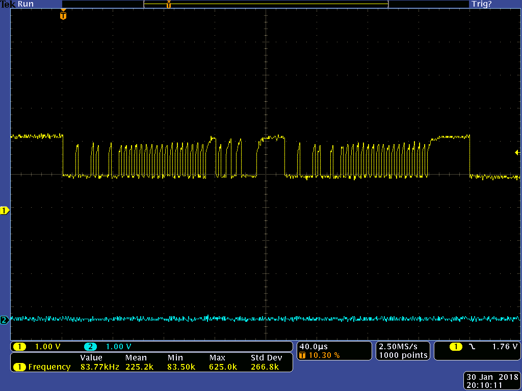

  • This is my co-worker's phone; mine refused to send the picture, but it came out the same: lighting plus the (actually very clean - just out of the package) surface texture make for what looks like dusty surface. I usually leave my Canon 5D and my Canon IS 100mm Macro lens at home when coming to work, although couple of times used it to make assy documentation. :)

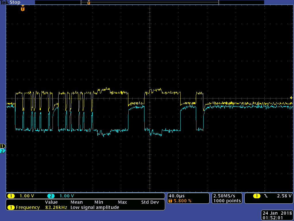

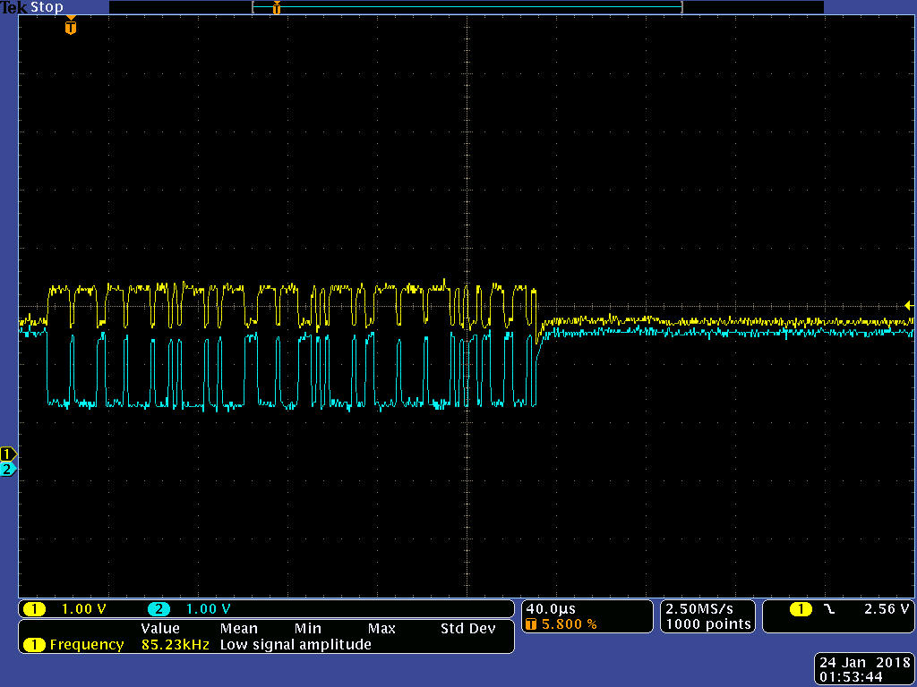

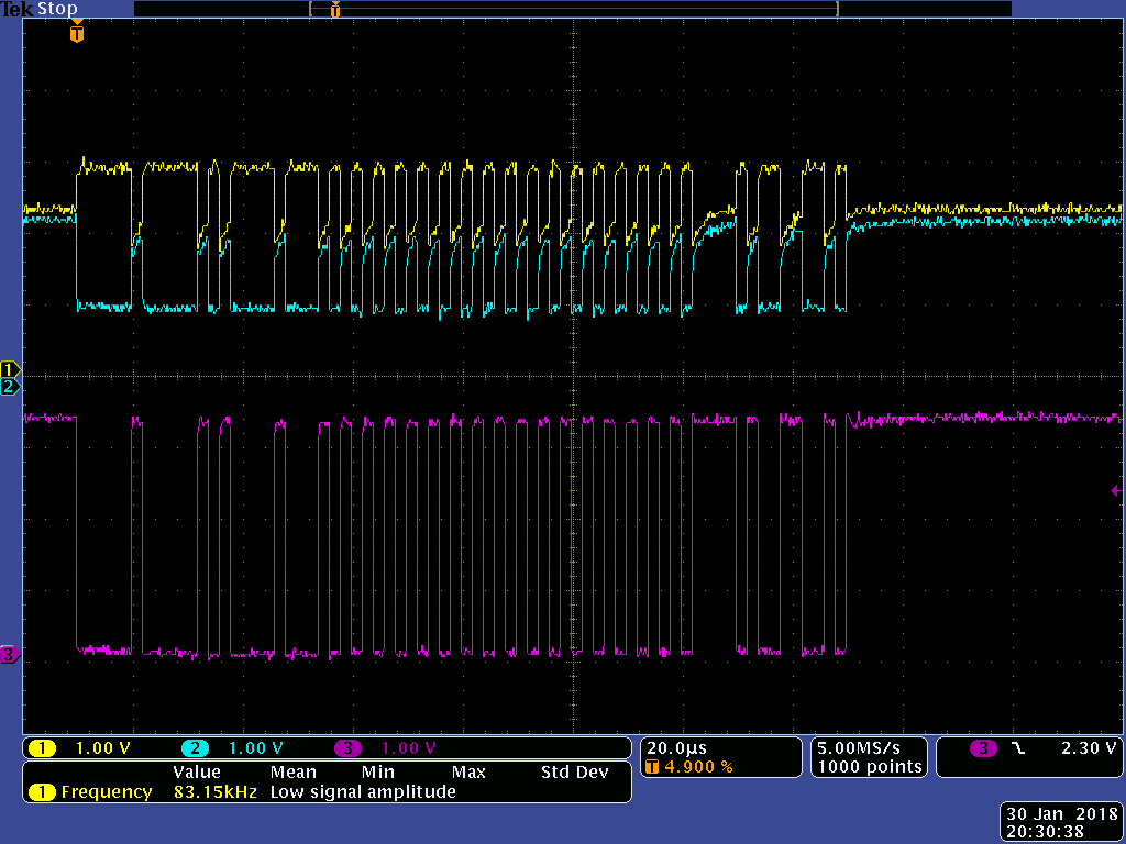

    Now, just to show the CAM waveforms (accounting for longish scope GNDs, but not much worse than I saw in the appnotes).
    The top to bottom - Good and Bad CAN communication. As you can see, in the case of the BAD the communication starts and then gets stuck at "0" (CAN levels spread apart), which is what one of the failure codes reflects.
  • I mean, BAD to GOOD, Bad is at the top and the GOOD is at the bottom pics respectively.
  • The scope caps (appear) to reveal different data - would not "identical data" prove more sound - easier to compare/contrast?

  • I looked more closely at the scope shots. First, it looks like you are running at about 500K baud instead of 100K baud. The narrow pulses on the scope shot look about 2uS wide, not 10uS wide. (It looks like the horizontal sweep is 40uS/division.) But it should still work at that speed unless some of the timings are way off.
    If the two scope pictures are of the same message being sent, the first discrepancy is the third recessive bit after the start bit in the failing case (top picture). Is the device that gets the fail codes the transmitter in this case? If it is, it would be good to see a scope shot with the CANL signal from the transceiver and the CANTX pin from the TM4C. The CANL signal should never be high (recessive) when the CANTX pin is low. The long dominant phase is an error frame (6 or more dominant bits). It is likely the result of a previously detected error, not the actual problem.

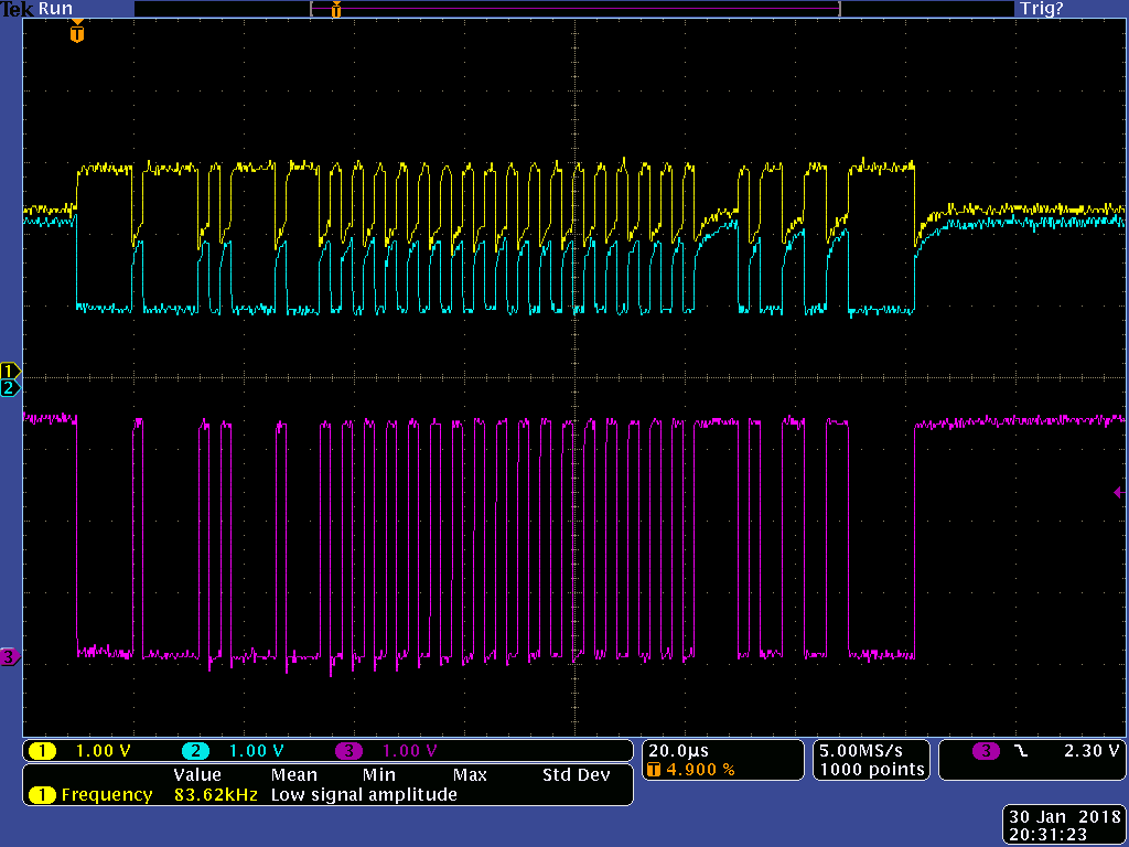

    From a power off condition here is the scope trace of the CANH, CANL and CANTX.
    Looks like all is good up until the ACK.  The transmitter reports CAN_STATUS_LEC_ACK.
    Leaving everything powered on, but just reprogramming the receiving board (sending a hardware reset has the same effect) and sending the command again all is good:
    Scott

    I used an LDO to create a separate +3.3V to feed to the VDDA.
    I lifted the VDDA pin alone, and connected it to an LP2981-33DBVR LDO output fitted with 4.7uF ceramic capacitor.
    First I used a 5V from a DCDC that is exactly the same as the 3.3V DCDC (adjustable type) as the input voltage.
    This did not result in any change in the board behaviour.
