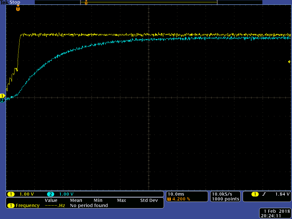

    I thought this would be the closing of it as I tried to emulate a supervisory circuit by simply delaying the reset after the voltages stabilized. This is a board without the yesterday mod, where the VDD and VDDA are tied together, and now I, having performed a feat of soldering thaumaturgy, slapped a 0603 1uF cap on top of 0402 0.1uF cap having delayed the RST signal by at leas 10ms.
    Below is the +3.3V VDD (yellow trace) vs the RST (Blue trace) at 10ms/div - 1V/div. (VDD also represents VDDA).
    I fully expected that to work except...it didn't. Same error.
    After performing a hard Reset, the board starts working.
    Am I missing something? Or is the Supervisor is not going to help and I need to increase the speed of +3.3V or delay VDDA vs VDD?

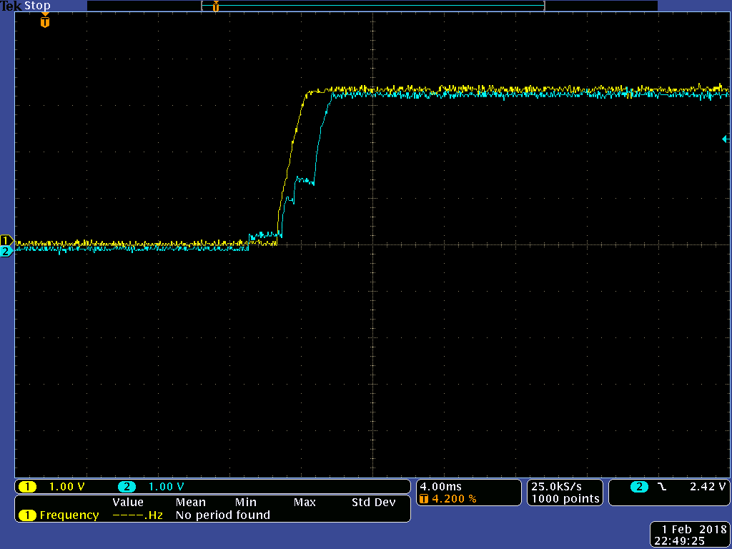

    Another thing, I just went to the datasheet for the power supply I am using, LDO03C by Artesyn (or are they Emerson today?) to see the max load capacitance: it seems that my value should be between the one listed for the outputs of 2.5V (1000 uF) and 5V (500uF) (they do not list 3.3V) - that is if I were to extrapolate coarsely,  this would be about  840uF max at 3.3V. I have under 300uF.
    Now, I rigged up a unloaded LDO with only on-chip capacitance and compared it with the board's one.
    Here's the pic. As you could see, although the start-up itself on the board is delayed due to the way the LDO handles the capacitance, the slope slew rate remains the same.
  • Hi Michael,
    I was afraid that the slow VDD rise time was inherent to the supply when you told me you only had 300uF of capacitance. What is confusing me is why the capacitor on RST did not work, but asserting RST later does. Can you try powering up with your jumper holding RST low and then removing the jumper?

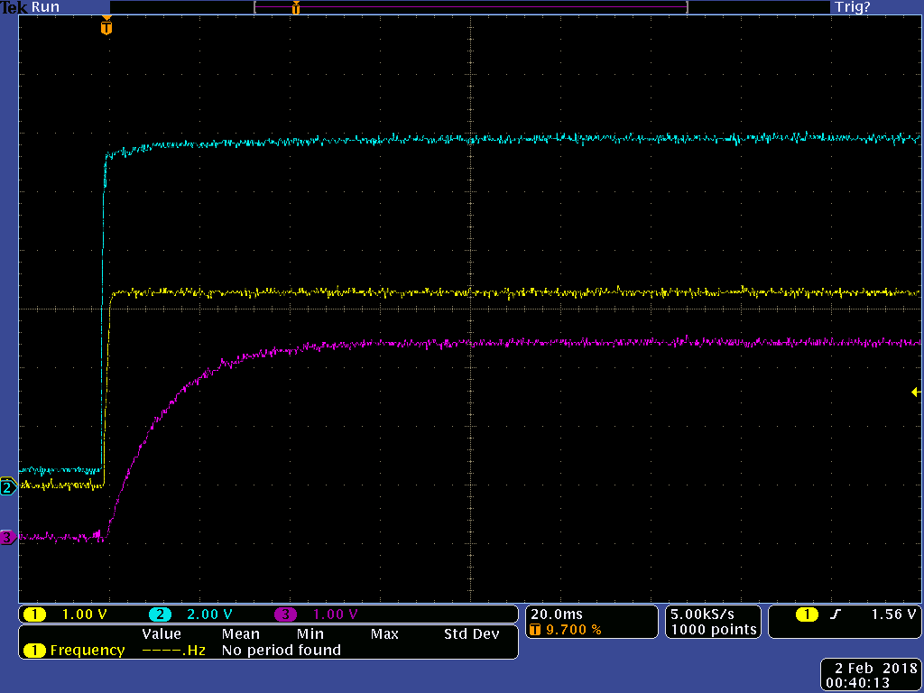

  • More takes:

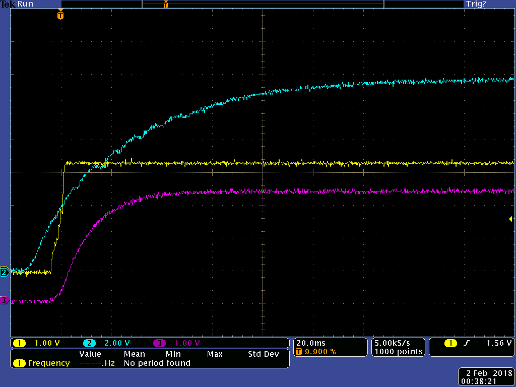

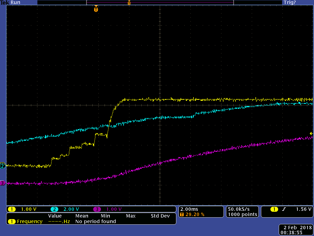

    I have decided to see if the lab power supply (3A/output or 6A parallelled) rise time affects the situation. The RESET is still staying delayed as before.
    For this I first took the picture of +3.3V  VDD (and VDDA) rising as the power supply is powered by pressing the "Power button". As you can see in the pics below, the 12V rises very slow and the VDD has those "steps" on it - obviously due to not enough difference between the Vin and Vout.
    Again, Yellow is VDD, Blue is 12VIN and the Purple is the RESET.
    And the blow-up of the same.
    Sure enough we are having the error.

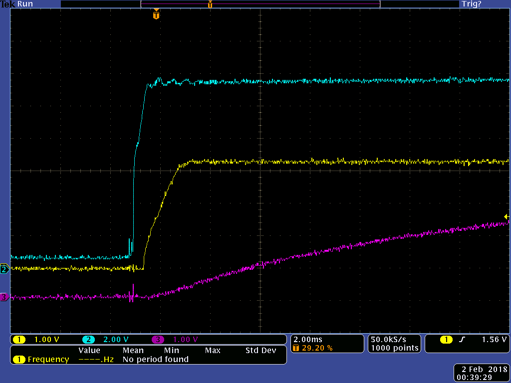

    Then I pre-energized the lab power supply and powered the card by plugging in the wire into the supply's Positive. That took care of the slow risetime.
    As you can see, no steps anymore, clean nice slope of the VDD, and, of course, well delayed RESET.
    And the blow-up at 2ms/div
    Everything is just nice. Except.....still the error, and consistently at that.
  • The last two experiments suggest that it is not as simple as corruption due to starting execution before the power has stabilized.

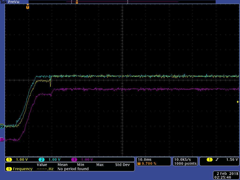

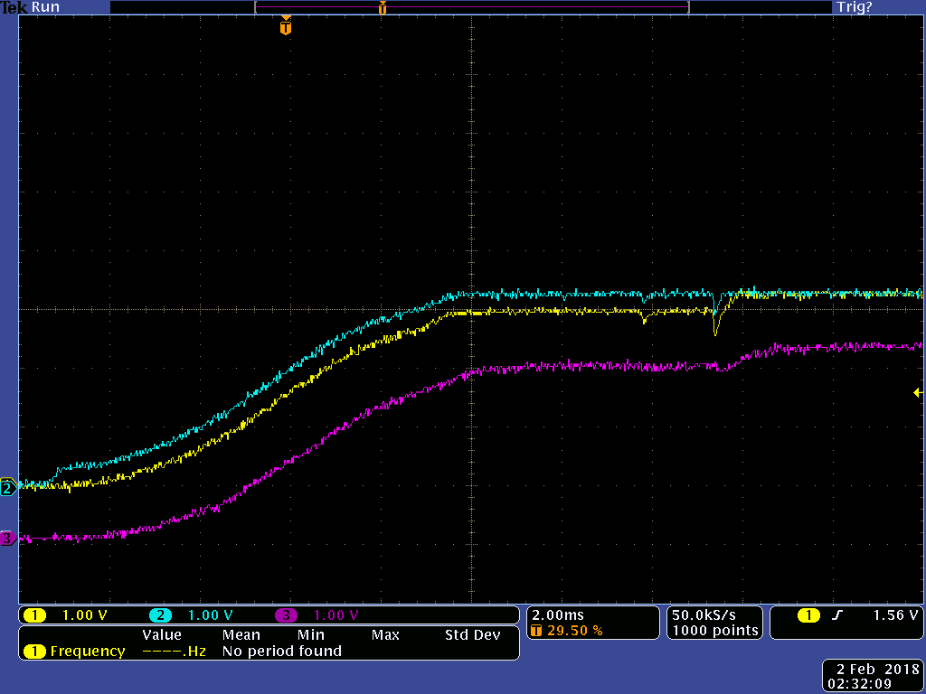

    Now, this board has separate VDD and VDDA, but unlike in the board with working CAN  (the one that works) while VDD is derived using exact same POL, the VDDA is derived the same exact way that I did in the experiment with the non-roking CAN board, when lifting VDDA pin and running it through an LDO connected to the 12Vin. So unless delayed with a resistor and an input cap, it will appear much sooner. As you remember, before I introduced the resistor, the non-working board still did not work, and then due to the delay after introducing 1K resistor between 12Vin and the LDO input it started working.
    So in the same exact fashion, the VDDA is derived as series of the two LDOs from 12Vin - 12V to 5V LDO, and 5V to 3.3V LDO becoming the VDDA.
    So, when having connected the board to the CAN bus, we have achieved exact same result as in the board with the non-working CAN: right after programming the code the board communicates fine, and after power cycling it goes into CAN error.
    The interesting thing is, the VDDA is just a little ahead of the VDD.
    These are the scope captures of the voltages and the reset.
    The Yelolow is the VDD, Blue is VDDA and the purple is Reset.
    And the blow-up
  • I just want to emphasize this: in the last board discussed in the previous post, though I am sure we are not using every single resource the CPU provides, we use quite a bit. There are no problems with anything we are using in this board. Including the analog portion that we use to measure signals provided by a load cell. Ethernet communication works fine. USB communication works fine. I2C communication that we use to provide extra GPIOs using IO expanders, works fine. SPI bus used to talk too D/A converters and to read/write the non-volatile memory, works fine. GPIOs that we need to provide step signals (which requires working with timers to provide speed accuracy) for stepper motors, as well as those asynchronous GPIOs responsible for enables, directions, and micro-step commands are all fine. And, of course, there's the Heartbeat LED.
    CAN is the ONLY function so far that is sensitive to whatever is going on with the power-up sequence.
    Oh.....just to anticipate the question, the CPU latch-up due to VDDA leading the VDD is prevented by the Schottky diode between the two, the VDDA driving the VDD.
