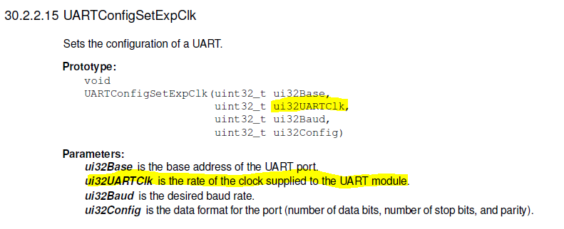

Hi, I'm trying to set up the UART module of my TM4C1294XL board but I can't answer a question: "If I want  to setup the UART module did I must call  the UARTClockSourceSet() function?"
In order to illustrate my problem, that's how I'm trying to configure the UART module
  /*Initialize GPIOC for UART*/
  SysCtlPeripheralEnable(SYSCTL_PERIPH_GPIOC);
  /*Enabling UART7*/
  SysCtlPeripheralEnable(SYSCTL_PERIPH_UART7);
  /*Configuring GPIO pins for port C*/
  GPIOPinConfigure(GPIO_PC4_U7RX);
  GPIOPinConfigure(GPIO_PC5_U7TX);
  /*Setting up GPIOC pins for UART function */
  GPIOPinTypeUART(GPIO_PORTC_BASE, GPIO_PIN_4 | GPIO_PIN_5);
  /*Setting UART7 clock source*/
  /*Setting UART7 configurations*/
  UARTConfigSetExpClk(UART7_BASE,UART_CLOCK_PIOSC,9600, (UART_CONFIG_WLEN_8 | UART_CONFIG_STOP_ONE | UART_CONFIG_PAR_EVEN))
I'm using UART_CLOCK_PIOSC in the second parameter of the configuration function because I want to have 16MHz for UART7 clock and I don't know if I have to call  UARTClockSourceSet(UART7_BASE, UART_CLOCK_PIOSC) before doing it.

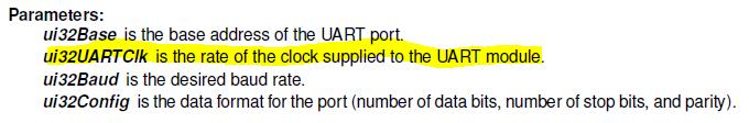

  • The second parameter of the function UARTConfigSetExpClk() is the source clock rate, not which source to use. If you use PIOSC as the UART clock source, then the second parameter should be 16000000 (for 16 MHz). The default UART clock source is the system clock, so unless you are using PIOSC as the system clock, you must call  UARTClockSourceSet(UART7_BASE, UART_CLOCK_PIOSC).

  • Thanks, Bob. That resolved my Issue :)
