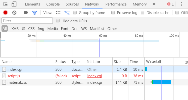

I am using HTTP Server with TI RTOS (latest version) on TM4C129EXL LP. My Problem is the following. I have an HTML file (static or cgi, doesn't matter) that links external resources like *.css and *.js.

When I add both resource to the target and hitting refresh button on the browser only each of referred files can be loaded. *.js or the *.css not both. I made some tests and realized that only the first referenced file can be loaded. In the above example the css is loaded because it is above than the js file. When I change the order the js is OK but css fails.
Please see the chrome screenshot
The error is: ERR_SOCKET_NOT_CONNECTED
Do you have any idea how to overcome this issue?
Thank you for your kind reply
