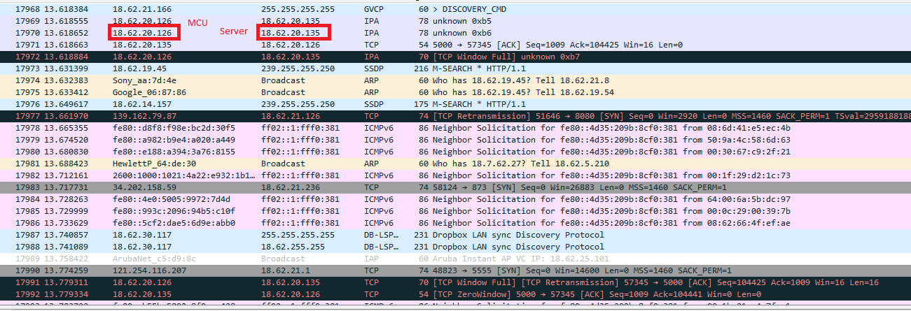

I am trying to add Ethernet communication to my existing project. I use TCP IP stack in TI-RTOS. When my MCU is configured as a server and my remote device is a client communication works fine. I stream 24 bytes approximately at 3kHz rate. I am trying to implement the opposite case with MCU acting as a client. I am able to establish connection, however after couple of seconds transmission stops. I have used Wireshark to look at the transmission communicates. I always get TCP WINDOW FULL, TCP RETRANSMISSION a couple of times and finally it ends with TCP ZERO COMMUNICATE. TCP client (MCU) stops transmission, even though  the send() command is in tcpHandler() task while(1) loop and semaphore or ctr1 variable (depending how I release the loop()) are being set by the interrupt. I used loging info to check that.
I attach fragment of my code below. I am currently triggering tcp_task from a timer interrupt (I tried using semaphores and dummy control variable to trigger task loop).

I have tried also assigning static IP to PC and Tiva and connecting directly with a switch. Same result.
