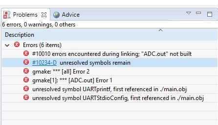

  • but there is another problem with Tivaware example code,its related to UART,when i upload the example code i get  following error.
  • HI Awais,
    Did you either link or copy the file uartstdio.c to your project folder? The uartstdio.c is located at <TivaWare_Installation>\utils\uartstdio.c Please do so and recompile again.
  • thnx Charles, issue was resolved after i copied the uartstdio.c and uartstdio.h to my project folder.
  • Glad your problem is solved.
