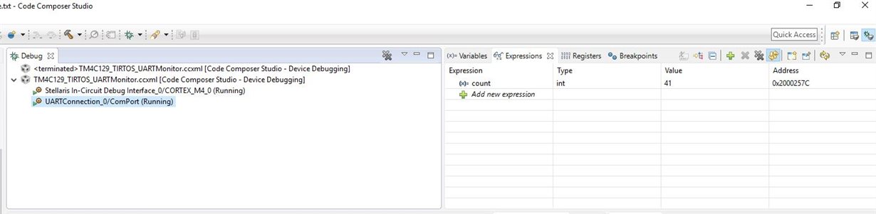

     Did you try the gpiointerrupt_EK_TM4C129XL_TI example?
     I just tried the above example and followed the user's guide to set up a new target configuration for the UART connectio and it is working for me on the LaunchPad. I tried to monitor the the variable count via the UART connection as shown below. As I pressed the switches on the board, the count will increment.

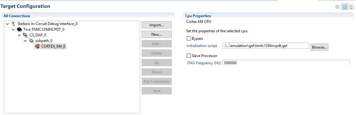

     So the error you see is when you tried to load the program to the flash, correct? Did you somehow change the .cmd file? Please also check if you use the correct target configuration file when you connect to the target. You target configuration should look something like below if you are using the launchpad with the Stellaris ICDI debug probe. If you are using a different debug probe then it will look different but still similar. I'm curious as to what gel file you are loading. The gel file specifies which memory regions are read or writeable.
     One quick experiment is -can you delete the existing gpiointerrupt_EK_TM4C129XL_TI project and go to resource explorer and re-import the same project again? After you import the gpiointerrupt_EK_TM4C129XL_TI example, try to rebuild it and will you still see the problem when loading the program?
