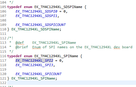

I have one more question if possible. The SPI ports that can be used for serial communication (in RTOS for my TIva) are SPI2 and SPI3? I couldn't find a definition of port 0 or 1 in the header files. It looks like ports 0/1 are used by RTOS drivers to service FatFs devices. Do I see this correct? Is there a way to use SP0 1 in non-FatFs case?
  • Hi Lukasz,
    The board file is setup to work with all the examples in TI-RTOS. You can change it as needed. For example, if you are not using FatFS, you can just remove the code (note: it is not pulled in if you don't reference it, but from a visual standpoint it might be cleaner to delete it).
    Todd
  • It means I can just refer to EK_TM4C1294XL_SDSPI0? But aren't both defined as 0?
  • Do you mean I could use SDSPI as a normal SPI? Then I can use SPI0/1.
  • Yes. Delete the SDSPI stuff and make this change in EK_TM4C1294XL.h
    typedef enum EK_TM4C1294XL_SPIName {
    EK_TM4C1294XL_SPI0 = 0,
    EK_TM4C1294XL_SPI1,
    EK_TM4C1294XL_SPICOUNT
    } EK_TM4C1294XL_SPIName;
    and the pinmux code in EK_TM4C1294XL.c under the
    * =============================== SPI ===============================
    banner accordingly
