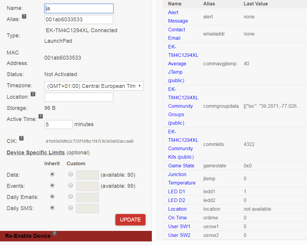

Hey everyone,
I am new to this community as well new to Tiva C series (TM4C1294 launchpad). I want to use Ethernet to connect to exosite. But i am facing problem in activating my device. It is showing my device as active in home menu but when i click on it, it is showing status “INACTIVE” and also displacing a statement like " This device has not yet been activated or does not exist. Please activate your device or confirm the device RID and try again".
Thanks in Advance.

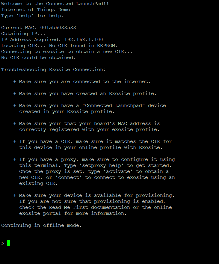

    Are you having problem with the preloaded example that comes with the LaunchPad? This post maybe helpful to your debugging. If you want to learn the ethernet capabilities, I will also suggest you try the various examples in TivaWare library under <TivaWare_installation>/examples/boards/ek-tm4c1294xl/ where you will find enet_io, enet_lwip and other ethernet related examples.
  • Did you type in console the activate command. Type ? or h, help, for the menu.
