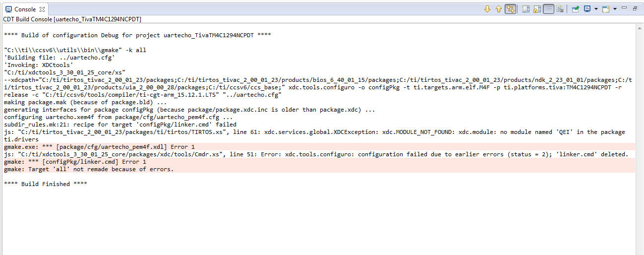

  • Respected sir/madam,
     I have solved the previous problem but i am getting another problem. I have attached console output and related files. And please give me step wise procedure of adding new peripheral in TI-RTOS. I am not able to figure out which files to edit or add.New folder.zip

    You need to add the QEI module to ti/dirivers/package.xdc, and add the appropriate code for QEI to ti/tirtos/TIRTOS.xs.  You need to then rebuild tirtos (instructions are in the TI-RTOS User's Guide section on building TI-RTOS for CCS).
    Then add to your application .cfg file:
        xdc.useModule('ti.drivers.QEI');
    If you can upgrade to a newer version of TIRTOS, we have removed all the driver xdc modules.  The modules were only there for ROV support for the drivers, which didn't turn out to be that helpful, so we removed them.  If you upgrade, you would just need the QEI header and source files.

  • respected sir/madam,
    I rebuild ti-rtos but it is not solving the problem. Same error is coming.
  • Hi Digvijay,
    By "Same error is coming", I assume you mean the one in the .zip file you posted earlier:
    From this error, it looks like either QEI has not been added to ti/drivers/package.xdc, or you have not rebuilt the drivers.  Here is what ti/drivers/package.xdc should look like:
    package ti.drivers [1,0,0] {
        module EMAC;
        module SDSPI;
        module I2C;
        module USBMSCHFatFs;
        module GPIO;
        module QEI;
        module UART;
        module SPI;
        module WiFi;
        module Watchdog;
    Here is how you can rebuild the drivers:
    1. Edit the tirtos_tivac_2_00_01_23/tirtos.mak file to set the DEFAULT_INSTALLATION_DIR.  This should be set to your CCS installation directory.  If TIRTOS is not installed in the save directory as CCS, you will also need to edit the TIRTOS_INSTALLATION_DIR variable.
    2. Clean the drivers
        - gmake -f tirtos.mak clean-drivers
    3.  Build the drivers
        - gmake -f tirtos.mak drivers
    Janet

  • Hi Digvijay,
    You need to cd into the tirtos install directory for the build.  From a CMD prompt:
    > cd c:\ti\tirtos_tivac_2_00_01_23
    > ..\xdctools_3_30_01_25_core\gmake -f tirtos.mak drivers
    I hope that solves the build problem.
    Janet
    That solved my problem. Thanks for all the help.
