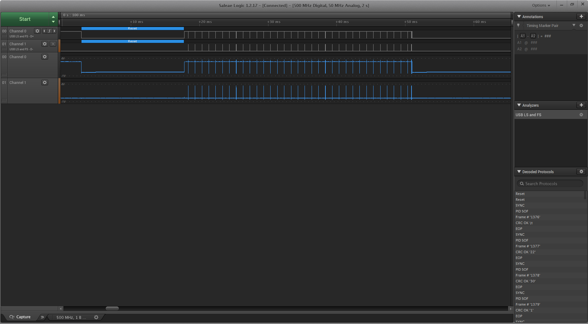

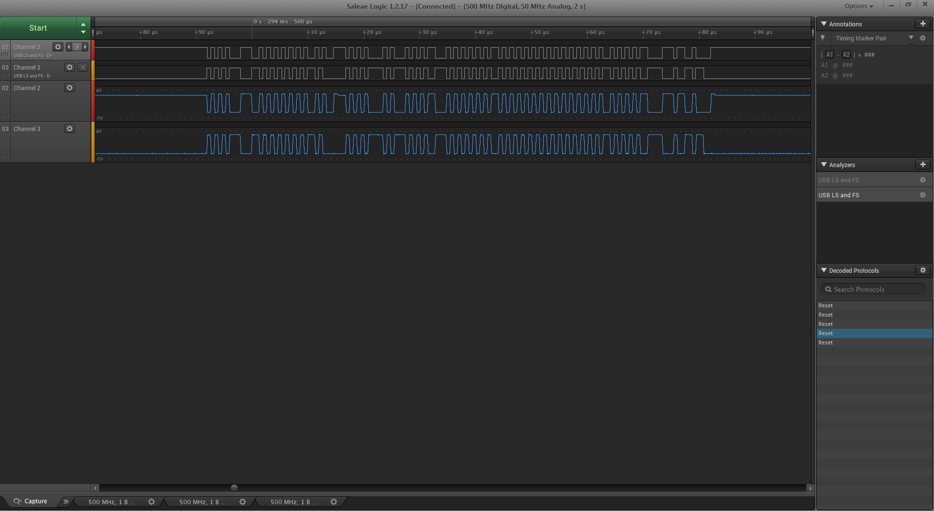

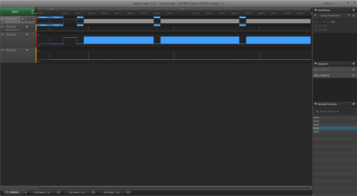

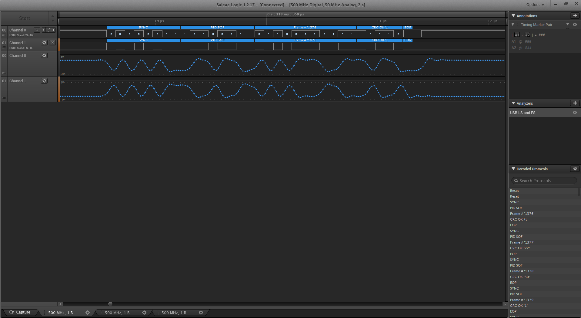

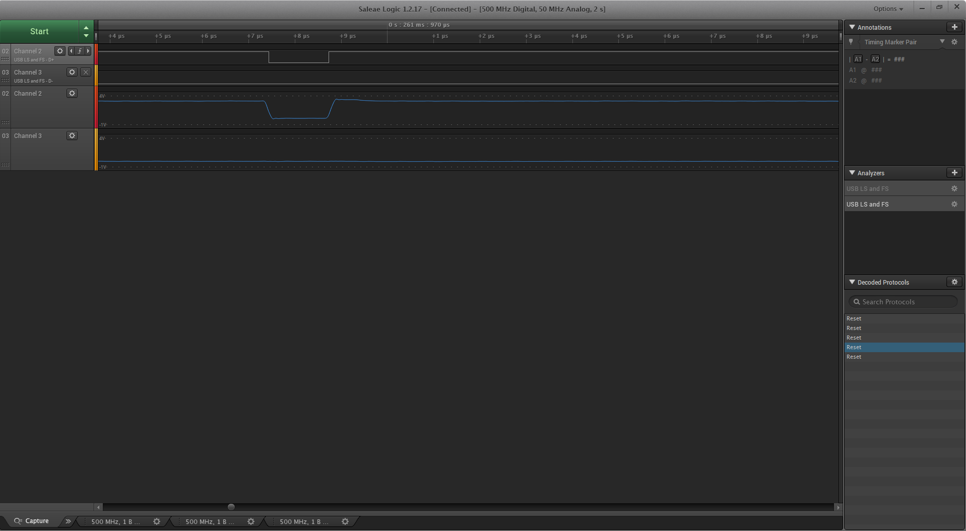

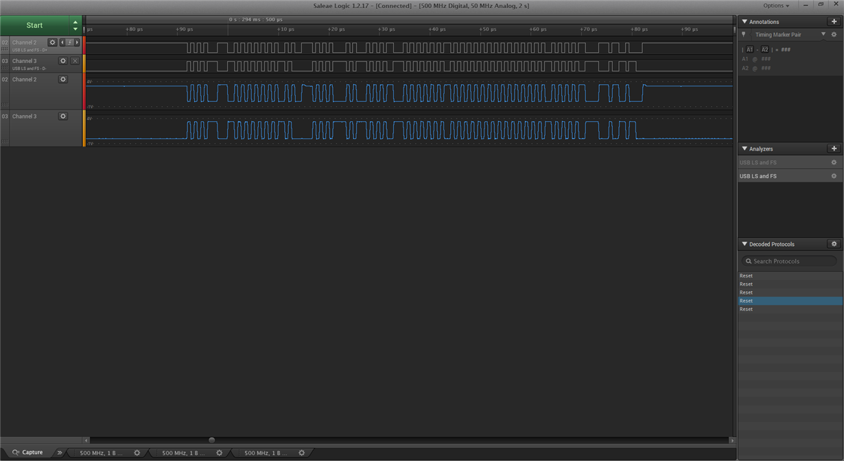

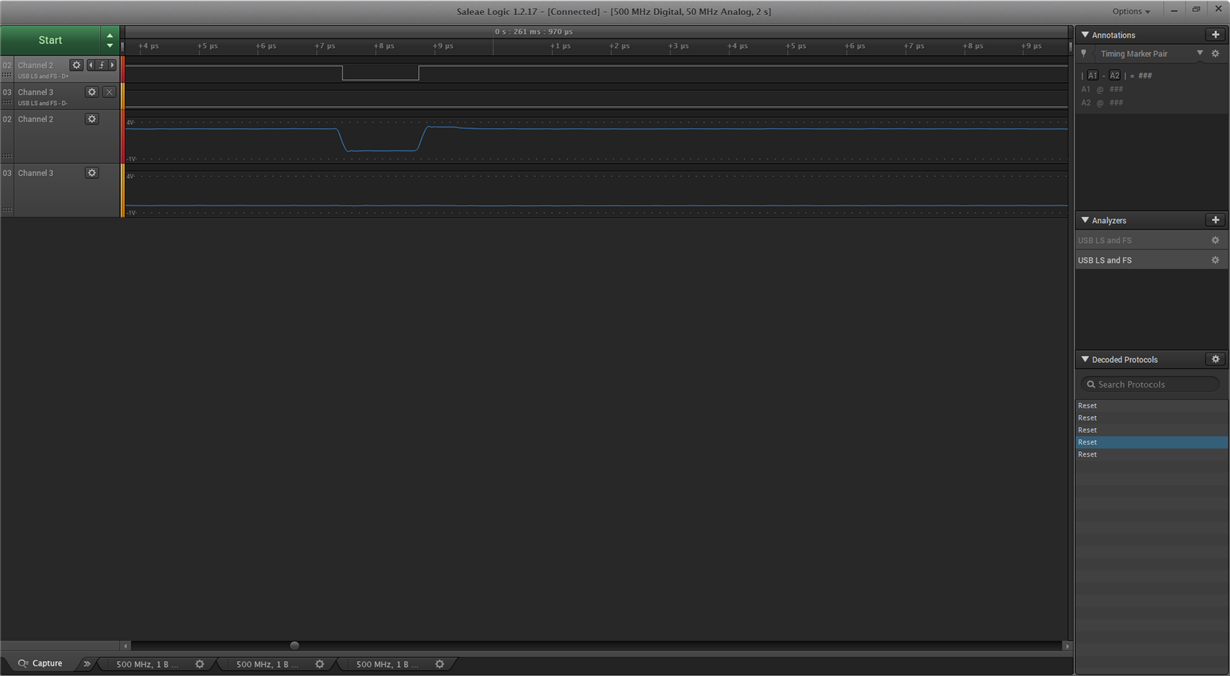

The USB startup code is the same as the start-up of the Bulk usb example provided in the Tivaware example. We are running the same code on the the DK as we are on our custom board, but get different results. I have attached some salae traces of the decoded USB messages.
What is confusing us is why the board does not respond, and when it does respond the analog traces look like digital traces (see attached traces). From what we can tell, there really is not much if at all anything that needs to be connected to the processor to get an internal PHY to work. It feels like there is just some simple and fundamental connection we are missing. We have also looked through the errata and did not see anything glaring at us.

We can tell the processor is running by monitoring the JTAG port - everything looks OK and it does not shutoff/restart.
TM4C129-DK
Custom Board
