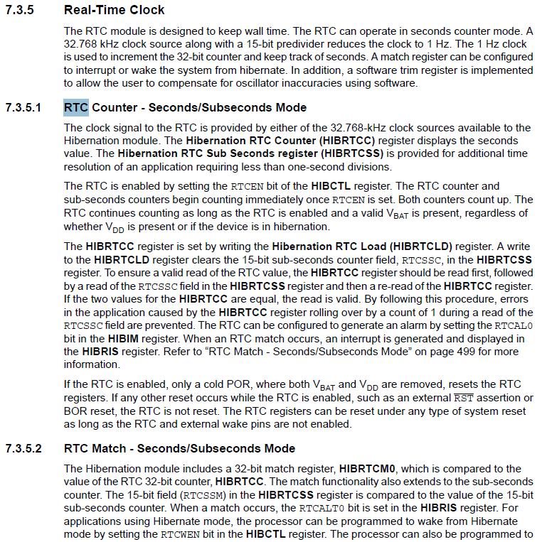

Hi all,
We have a 32.768 kHz oscillator connected to pin 66 (XOSC0) to provide for a Real Time Clock. But how to use it? I failed to locate any TivaWare APIs for setting up or dealing with the RTC. Nor could I find an example program in TivaWare. Any pointers?
  • I was surprised by your, "report of difficulty."      And then - could NOT find RTC data either!
    As a "big fan" of the  "Peripheral Driver Library Guide" - I "searched under "RTC" - and rather than having its own "section/segment" - the bulk of  "RTC Data is cast w/in the "Hibernate Section!"     (who knew - yet there is (some ... although minimal) logic in that.
    Even better - "Searching for "RTC" w/in our 4C123 manual - opened a "Pandora's Box" of  "hits."    (over 100!)     Below - one representative sample:
    I suspect that same investigation of "Hibernate" w/in (your) MCU Manual - will further detail.

  • I found the RTC functions. Given that this is part of the Hibernation module, the TivaWare functions for dealing with Real Time Clock and Calendar are in:
    C:\ti\TivaWare_C_Series-2.1.4.178\driverlib\hibernate.c.
    I had a much-too-difficult time finding that.
