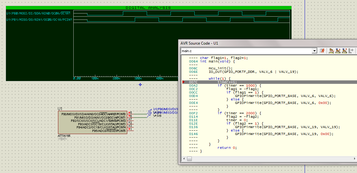

  • as your code is poorly formatted, here is a reformatted while() loop - hopefully it will make your analysis a little bit easier:
        while(1) {
        	timer+=1;
            if (timer == 1000) {
                flag1 = -flag1;
                if (flag1 == 1) {
                    GPIOPinWrite(GPIO_PORTF_BASE, VALV_6, VALV_6);
                } else {
                    GPIOPinWrite(GPIO_PORTF_BASE, VALV_6, 0x00);
            if (timer == 2000) {
                flag2 = -flag2;
                timer = 0;
                if (flag2 == 1) {
                    GPIOPinWrite(GPIO_PORTF_BASE, VALV_19, VALV_19);
                } else {
                    GPIOPinWrite(GPIO_PORTF_BASE, VALV_19, 0x00);
    an analysis of it is fairly easy.
    let's assume flag1=flag2=-1 at time 0/timer=0:
    time0/timer=0: flag1=-1/pin6=0, flag2=-1/pin19=0;
    time1000/timer=1000: flag1=1/pin6=1, flag2=-1/pin19=0;
    time2000/timer=0: flag1=1/pin6=1, flag2=1/pin19=1;
    time3000/timer=1000: flag1=-1/pin6=0, flag2=1/pin19=1;
    time4000/timer=0: flag1=-1/pin6=0, flag2=-1/pin19=0;
    so basically every 2000 counts on timer, pin6/19 are flipped (period = 4000 counts), except that pin6/19 are 90 degrees out (off by 1000 counts).
    a quick simulation on an avr showed the same results.
    now, I have no idea if that's what behavior you wanted - since you haven't told us. but if that's not what you observed, your problem is somewhere else.

  • generating quadrature outputs can be done with timers / compare match. you can specify the phase difference and once set-up, it can be done without the cpu involvement, freeing it up to doing other things.
    here is an example: dannyelectronics.wordpress.com/.../
    the chip is different but the basic concept is the same.

    you don't need that kind of complexity: you can do it in the main loop, and with timer count directly, like this:
      switch (timer) {
        case 1000: //do something with gpio
        case 2000: //do something with gpio
        case 3000: //do something with gpio
        case 4000: //do something with gpio
                   //reset timer
                   timer=0;
    you can also put this in the isr but in my view much cleaner and a lot more readable to have it in the main loop.

    No.
    If you do that, then you will run into the problem where you might "miss" the timer equalling 1000, 2000, 3000, and 4000.
    It might not happen today. But tomorrow, additional code will be added to do other things, and that code will take longer to execute. You might execute your "switch (timer)" statement when timer is 999, then again when timer is 1001. The resulting waveform will be incorrect. This will all happen because timer changes asynchronously to execution of the main loop. If you do it in the interrupt, then it will work because timer increments synchronously to the "switch (timer)" statement.

    Waveforms should be generated by hardware peripherals if possible, because that results in a far more accurate waveform (better timing, less jitter) than one generated by software.
  • I generally resist the temptation to execute much in the isr.
    "You might execute your "switch (timer)" statement when timer is 999, then again when timer is 1001. "
    two ways to solve that:
    1) use flags in the isr and execute off the flags in the isr;
    2) increments in larger time duration. so rather than in 1ms (=1 count), as it is now, increments in 1s (=1000 count). so you lower the risk that you have a long task causing output jitter. in this case, your timer will go from 0->1->2->3->4/0->1...

  • Nicely done twelve, the state machine is a good idea.
    Only one caveat, and I don't think we know enough here to know how to follow it in this case. Structure the state chart to follow the problem, not to follow coincidental timing. IE if you have two outputs that are notionally independent implement separate state machine for them even if the output changes coincide over some portion of the timing (even if that portion is all of it). This makes maintenance substantially easier.
    Something like Yakindu makes this kind of maintainence and documentation easier as well.

    twelve12pm said:
    Strictly speaking, switch statements should have a "default" clause that performs some recovery from whatever inexplicable situation that causes the "state" variable to contain garbage.
    Yes and certain quality standards (such as MISRA and a number of security standards) make that mandatory. It's a good practice to get into and it costs you little. A good static analyzer will support this as well.
    twelve12pm said:
    Someone will surely point out that my "timer" and "state" variables are not declared volatile.
    Nope, there are two ways of using volatile incorrectly
    1. Not using it when it is needed
    2. Using it when it's not needed
    You don't appear to have committed either fault. Using volatile here would be a mistake, needlessly constraining the compiler.
