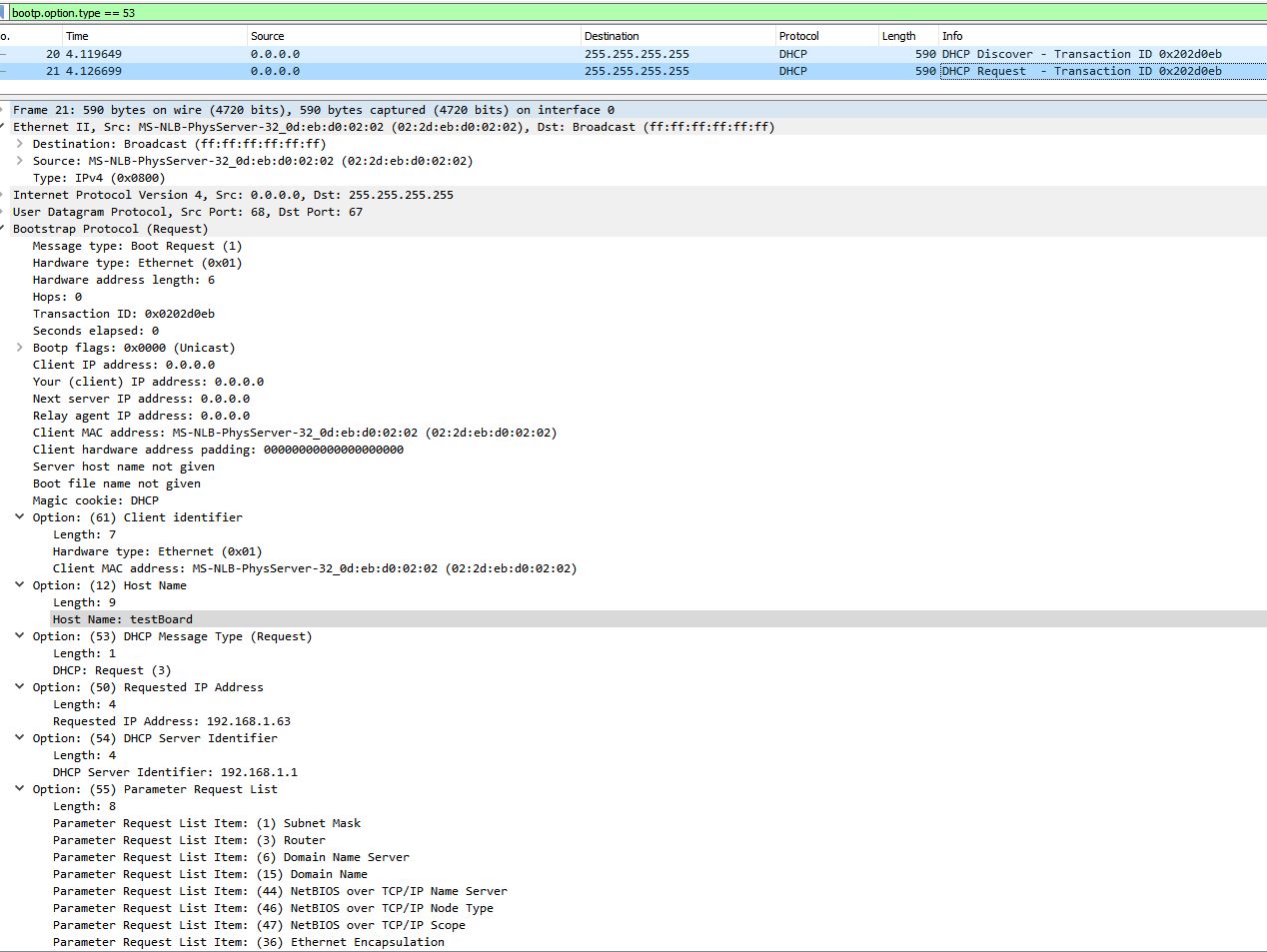

    What do you see for "hostname" in the DHCP transaction in Wireshark?
    Steve
  • Hi Steve, Thanks for your reply.
    DHCP Discover and Request do have the correct Hostname "testBoard" at DHCP Option 12 set. Please don't get confused by the MAC address, this is randomly generated.
  • OK, that looks good.

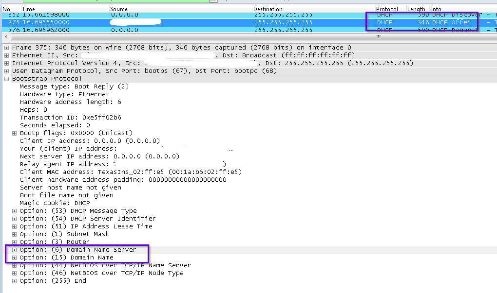

    What about the DHCP offer that the server sends you? (note that it will be sent to the broadcast address).
    Do you see options 6 (domain name server) and 15 (domain name)?
    Steve

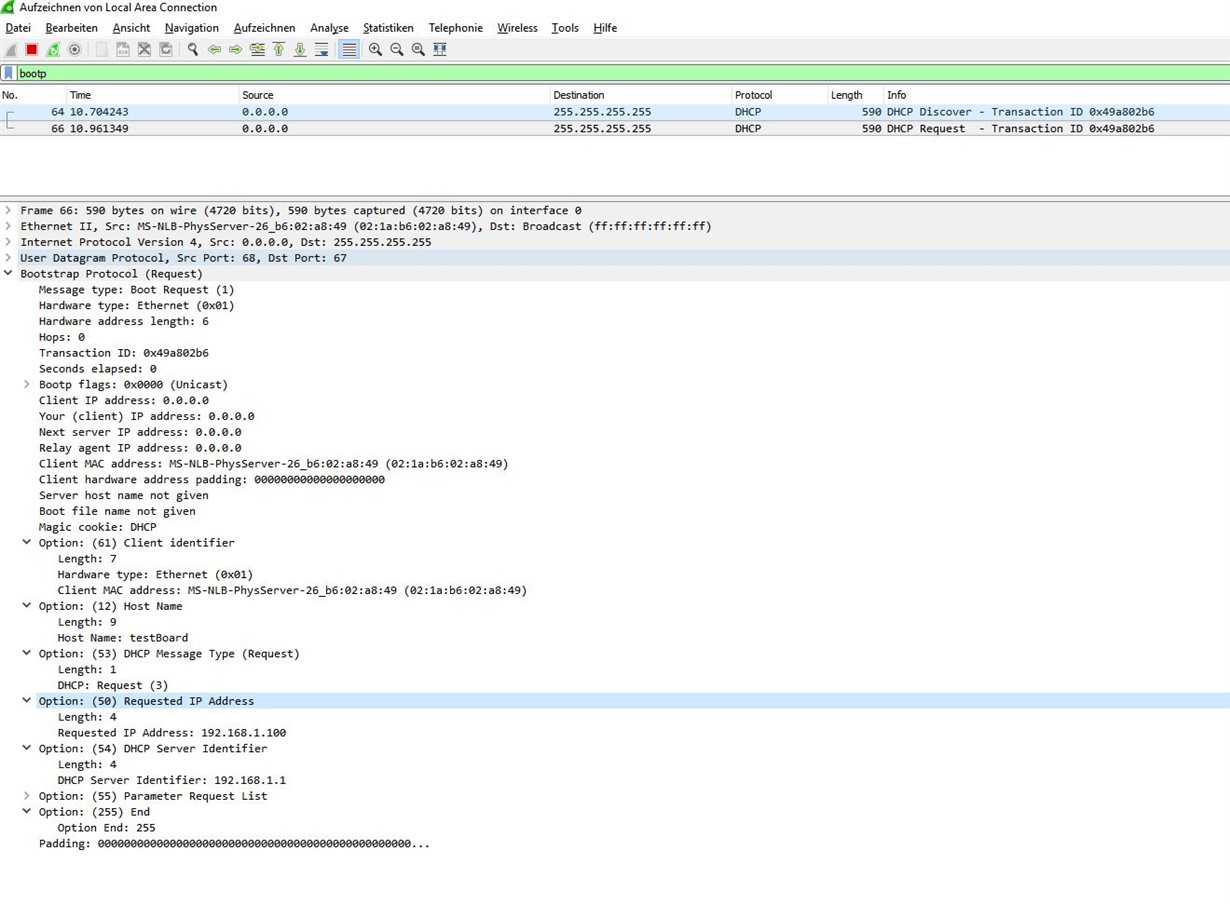

  • Hi Steve
    Hmm, unfortunately I only see the DHCP Discover and the Request. I cant see any Offer or Ack. Strange, because the TivaC is getting a valid IP Adress so far...
