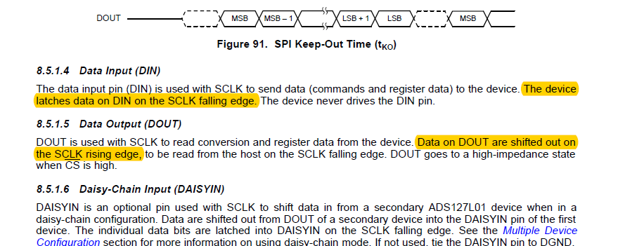

I have a quick question. My SPI configuration requires receiving data on a rising edge and transmitting on a falling one. Based on the MCU datasheet I am not convinced that any of the Freescale SPI frames allows for that. This is requirement of my ADC slave.
I have used this ADC in past with one of the C2000 controllers, however, there I could specify clock polarity for TX/RX action separately or the 1/2 delays. Can I configute tm4c1294 using PH, PL (modes 0-3)?
  • I think this configuration is what you want:, the ADC DIN connects to SSInTx and the ADC DOUT connects to SSInRx.

  • I got confused with the Modes names. Even between TI MCUs devices PH and PL bits meaning can vary. Thanks you s lot.
    That's, sadly perhaps, not  an uncommon vendor documentation issue. I have found that often the fastest and surest method of determining the phasing a particular SPI configuration will provide is the use of a scope or logic analyzer. Don't be tempted to judge correctness by the IC appearing to behave 'correctly', minor phase delays can make it appear to do so even in some incorrect modes but leave you at the mercy of process, voltage and temperature caused variations.
