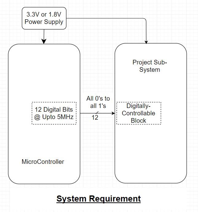

Hello all,
In my project, I want to control 12 digital bits (All 0's to all 1's) at rate upto 5Hz (It may be 1MHz, 2MHz, 3MHz, etc.)
Note :- There is no relation of Analog to Digital conversion, ADC, Sampling rate, etc.
Please suggest me which micro-controller should I use for this application?
Micro-Controller has to work on 1.8Volts or 3.3Volts DC power supply.
Just now, I have evaluation kit of TM4C123, so that I'm trying to do job done on same.
But you can also suggest me other Micro-controllers, Counters, Timers, etc.. to job done.
For reference I'm attaching the system requirement block diagram.
Thank you.
  • 12 bits that are all 0s or all 1s? Wouldn't that be one bit fanning out to 12 inputs?
    If you want to output some 1s and 0s on a pin at upto 5Mhz, pretty much any modern mcu can do that. Your tm4c is certainly one of them.

  • Hello Suraj,
    I interpreted your question differently from Danny and CB1. Please clarify for us. Are you trying to make a digital 12-bit counter that outputs 12 lines in the sequence 000000000000, 000000000001, 000000000010, 000000000011 ... 111111111111? If this is the case, it can be done with the GPIO pins, but there is a catch. The pins will not all change state at exactly the same time. The GPIO ports are 8-bits wide, and those 8-bits will change state at relatively the same time, but a pin going high to low may change state faster than a pin going low to high or the other way around. What is more serious is that to change 12 pins requires writing to two ports. The transition from 000011111111 to 000100000000 will look like 000000000000 or 000111111111 for a short time. How will your sub-system react to the pin transitions? Is there some additional signal to tell your sub-system when the 12 signals are valid?

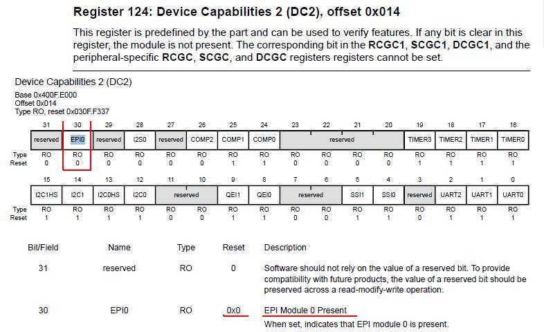

    Could not the poster simply use the External Peripheral Interface (EPI) 8-/16-/32- bit dedicated interface for peripherals and memory?
    No need to torment vendor's Bob w/this one.      Poster identified his MCU as '123 - I opened that MCU Manual - searched for "EPI" - NO "EPI" Chapter nor Segments resulted!
    What did reveal was the following:
    Items in highlight confirm - EPI was "Not included" w/in the '123.   (it IS a simpler, lower cost device)
    This - along w/Zero "EPI" Chapter/Segments - rather strongly - suggests that the "EPI" is  "Non-Resident" w/in poster's  '123 MCU...
    Thus - "NO" ...  poster could not, "simply use" a "non-existent Peripheral.      (EPI in this case - )
  • And that would suggest the poster has selected the wrong MCU for the job.
  • Not necessarily - much depends upon poster's application - which as presented here (per usual),  "Lacks sufficient detail."
    Further - those EPI bits you propose are NOT LATCHED - are they?       Should poster seek "latched" - another chip would be required.
    Your EPI idea DOES provide the ability to overcome this vendor's,  "8 bit per Port Limitation" - long since eclipsed by others...      (even without - especially without - "EPI-Like" implementation ... i.e. via  "wider GPIO Ports!")
