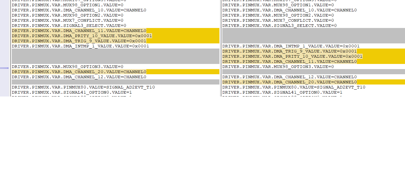

I have a Halcogen project originally created in Halcogen version 4.06, recently updated to version 4.07.
If I simply open Halcogen and save the project without making any changes, then compare the original .dil file to the newly saved .dil file I see that there are many changes. The changes are in the order in which settings are stored in the .dil file, not the actual content. If I sort the file I can see that the only content difference in the file is the generated date..no settings changed.
Why is Halcogen writing out content to the dil file in a different order?  Note that I have a 2nd project, also originally created in 4.06 and updated to version 4.07 which does NOT exhibit this behavior, i.e. if I simply save the project the only difference I see between .dil files is the saved date as expected.
Attached is a screenshot with a typical difference, see that the content is the same but the order is different.

  • Thank you for your reply. I have reviewed the release notes and did not find anything related to my problem. I know that the order of content will not affect the code output by Halcogen but it makes it difficult to perform a peer review. Any time a Halcogen change is made a developer will review the changes by looking at the hcg and dil files.
    One thing I notice is that the content order is not changed every time you click save project in Halcogen. It only changes if the Halcogen project is re-opened and then the project is saved. We can work around this problem but it would be preferred if we did not have to.
