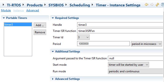

I am using TIRTOS 2.16.0.14.
In my project, I am using timer3 which is created in the .cfg file as shown below. I am starting the timer from my function.
Now it is working with a period of 1s.  I want a timer with 1us period. To, achieve this, how the period has to be set? If the period is in counts, what is the maximum count I can set?

  • Hello Sandra,
    The period can be set in microseconds when using the Timer - Instance Settings. Have you tried using '1' as a setting for it?
    If that doesn't produce a 1us period suitable for your needs, you may need to avoid using the TI-RTOS Hwi Dispatcher as stated here: e2e.ti.com/.../2105916

  • Hello Sandra,
    I believe setting the period to "1" instead of "1000000" within the configuration you have shown there would work then. But keep in mind the counter would be finite in size and with 32-bit timer, you'd still run out of count within 3 days. Not sure if you are planning to reset the counter before that occurs.
    You would need to list 'null' for the timer ISR function rather than the 'timer3ISRFxn' you have listed currently.

  • Have you considered using Timestamp_get64() and then converting the result into microseconds using Timestamp_getFreq() to determine the units of the value returned in Timestamp_get64()?
    Types_FreqHz freq;
    Types_Timestamp64 time;
    UInt64 frequency; /* in MHz */
    UInt64 timeInUs; /* time in microseconds */
    /* do the following once */
    Timestamp_getFreq(&freq); /* freq is in Hz */
    /* convert freq to MHz */
    frequency = ((UInt64)(freq.hi << 32) | (freq.lo) ) / 1000000;
      * from then on, simply do the following to obtain the elapsed time since the system started up
    Timestamp_get64(&time); /* get current timestamp */
    timeInUs = ((UInt64)(time.hi << 32) | (time.lo) ) / frequency; /* convert to microseconds */
    Alan

    For this device, the timestamp timers are clocked at the same frequency as the CPU. Therefore the frequency returned by Timestamp_getFreq() will be the CPU frequency.
    Alan
