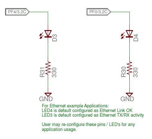

We are using TIVA C for a Ethernet to UART application and
we have some improper LED blink even though the communication is normal.
TI-RTOS Version:2.16.01.14
PF4/EN0LED1 and PF4/EN0LED1 ports are used to connect the Ethernet LEDs.
Below is the normal operation.
PF4/EN0LED1 -> Blinks according to the Ethernet Communication
PF4/EN0LED0 -> Indicates Ethernet connection is establised
The host device(Gateway) sends commands to the Tiva C(through Ethernet) every 200ms.
In this case the PF4/EN0LED1 should blink every 200ms, but it is not not blinking,
instead it is ON all the time.It could be recovered(blinking state) by reconnecting the Ethernet cable.
The Ethernet communication itself is working normal,but only the LED blinking is not working properly.

  • When I ran the tcpecho example on the launchpad I see D4 LED always ON and the D3 LED blinking which confirms customer's observation. I think PF0 is to indicate the Ethernet OK status while PF4 is to indicate the TX/RX activities. The TI-RTOS has the comments reversed. Please see the launchpad schematic below.
    GPIOPinConfigure(GPIO_PF0_EN0LED0); /* EK_TM4C1294XL_USR_D3 */
    GPIOPinConfigure(GPIO_PF4_EN0LED1); /* EK_TM4C1294XL_USR_D4 */
    GPIOPinTypeEthernetLED(GPIO_PORTF_BASE, GPIO_PIN_0 | GPIO_PIN_4);
  • Hi Charles,
    Perhaps
    You have to enable EN0 LED0 as link / LED1 blink rate is either 5Hz or otherwise some other choice.
    MAP_EMACPHYExtendedWrite(EMAC0_BASE, 0, EPHY_LEDCFG, EMAC_PHY_LED0LNK_LED1ACTY);
    MAP_EMACPHYExtendedWrite(EMAC0_BASE, 0, EPHY_LEDCR, EPHY_LEDCR_BLINKRATE_5HZ);
