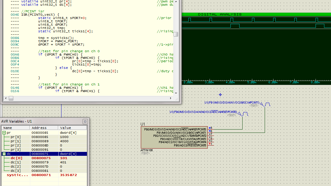

  • There are a lot of problems with the code. For example, I wouldn't use intdefaulthandler as my isr name....
    You may want to think what kind of signal you are trying to measure and think through an approach first.
    For fast pulses I would consider using captures.
    For slower pulses, the possibility opens up. For example you can use gpio interrupts and read off a free running clock for duty cycles...
    But first you have to understand the beast (pulse train) you are dealing with.

  • here is a demo of the approach I wrote earlier, on an ATtiny @ 8Mhz, 8:1 prescaler:
    the ISR is quite simple:
    //PCINT isr
    //count cycles on both edges
    ISR(PCINT0_vect) {
    	static uint8_t sPORT=0;					//prior state of the port
    	uint8_t tPORT;							//current state of the port
    	uint8_t dPORT;							//1->pin changed state
    	uint32_t tmp;							//time stamp
    	static uint32_t ticks1[4];				//rising edge timestamps
    	tmp = systicks();						//timestamp the edge
    	tPORT = PWMCH_PORT;						//read the port
    	dPORT = tPORT ^ sPORT;					//1->pin changed state
    	//test for pin change on ch 0
    	if (dPORT & PWMCH0) {					//ch0 has changed state
    		if (tPORT & PWMCH0) {				//rising edge on PWMCH0
    			pr[0]=tmp - ticks1[0];			//period = distance between two rising edges
    			ticks1[0]=tmp;					//update rising edge time
    		} else {							//falling edge on PWMCH0
    			dc[0]=tmp - ticks1[0];			//duty cycle = distance between rising and falling edges
    	//test for pin change on ch 1
    	if (dPORT & PWMCH1) {					//ch1 has changed state
    		if (tPORT & PWMCH1) {				//rising edge on PWMCH1
    			pr[1]=tmp - ticks1[1];			//period = distance between two rising edges
    			ticks1[1]=tmp;					//update rising edge time
    		} else {							//falling edge on PWMCH1
    			dc[1]=tmp - ticks1[1];			//duty cycle = distance between rising and falling edges
    	//repeat for other channels
    	sPORT = tPORT;							//save the state
    I'm counting two pwm inputs:
    ch0: 1Khz, 10% duty cycle -> pr[0]=1000us, dc[0]=100us;
    ch1: 250Hz, 10% duty cycle -> pr[1]=4000us, dc[1]=400.
    here is a screen shot of the simulation:
    Our period counts are spot on: 1000 and 4000, our dc counts are 101 and 401, off by 1 count.
    Now, your chip will be different, and your code will be different, but the basic concept behind it will be identical. if anything, the isr will be quite a bit simpler on your chip.
    if you take much more than that to do it, there is something seriously wrong.
    Will not be the "first time" then - that this reporter falls into the, "seriously wrong" category...
    In general - I applaud the cleverness demonstrated w/in your code - yet believe (some) more ... IS required!      (unknown is whether "some" rises to poster's definition of  "much.")
    "Some" or (even dreaded) "More" follows:
    • unstated is the "Calling Mechanism" for the ISR!     May we assume that GPIO's are driven by external,  (PWM signals) and that each/every GPIO - so driven - has been programmed to "Interrupt upon such external signal's, "Edge?"     (that should have been included - should it not?)
    • variable  "dPORT" likely defaults to the "lowest PWM channel" - yet the ISR reveals,  "No mechanism" to alter "dPORT" - so that (other) channels may be examined.    Is this true?
    • it is thus assumed that  (somehow)  "dPORT" is (loaded and "aimed") ... outside of the ISR.    (this so - "other" than the "default  dPORT channel" is selected.    Is this correct?      And - if  so - how do you propose "best" implementing this?
    • agree that "w/in the ISR" is NOT the place to calculate the input signals'  Frequency or Duty Cycle - yet the "Coordination & timing" of that (may) demand (some) explanation...    (if clarity is indeed, a goal)
    Your effort is appreciated - yet I continue in the belief that  "KISS" -  by far - best serves the requester.     His first task must be to capture & confirm the measure of a single pulse - NOT a "Pulse Bombardment!"
    Had you "had more time" - it is certain that more "intuitive or recognizable" variable names - could have been chosen.      (dPORT, tPORT, sPORT, tmp ... Not so much!)
