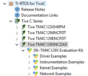

  • Hello eman,
    We have examples for the DK-TM4C129X included with the TI-RTOS for TivaC package. You can find them in resource explorer under TI-RTOS for TivaC -> Tiva C Series  -> Tiva TM4C129XNCZAD:
    By weather application, do you mean qs-weather example from TivaWare? If so the full source is provided with it. That example doesn't exist on TI-RTOS however. You would need to start with a Network Example for Ethernet and then add in the qs-weather functionality.
