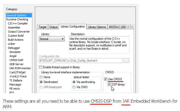

  • Such "Programming Approach" may NOT be exclusive to CMSIS!       Is not poster's failing code,  "SYSCTL->RCGCGPIO |= 0x20;" - a "Pointer-Based" version of  "DRM?"    While poster's code avoids the (usual) "HW_REG macro" (which converts address values to C pointer) - the effect is (exactly) the same.      Note that,  "Each Register referenced must be defined as a pointer."
    Ralph's identification of poster's "DRM" approach - appears likely - as  multiple, special "CMSIS" files must be deployed if CMSIS use proves exclusive.     (it is hoped that poster's instructor would have directed attention to the demands CMSIS imposes!
    Now our firm employs the IAR IDE (highly similar to poster's Keil) - and the addition of  "CMSIS" - is spectacularly eased.      (Presented below - do NOT blink!)
    Is it possible that our poster "missed" a (similar) checkbox - w/in Keil - and (that) - was ALL that was lacking?      We hope!
