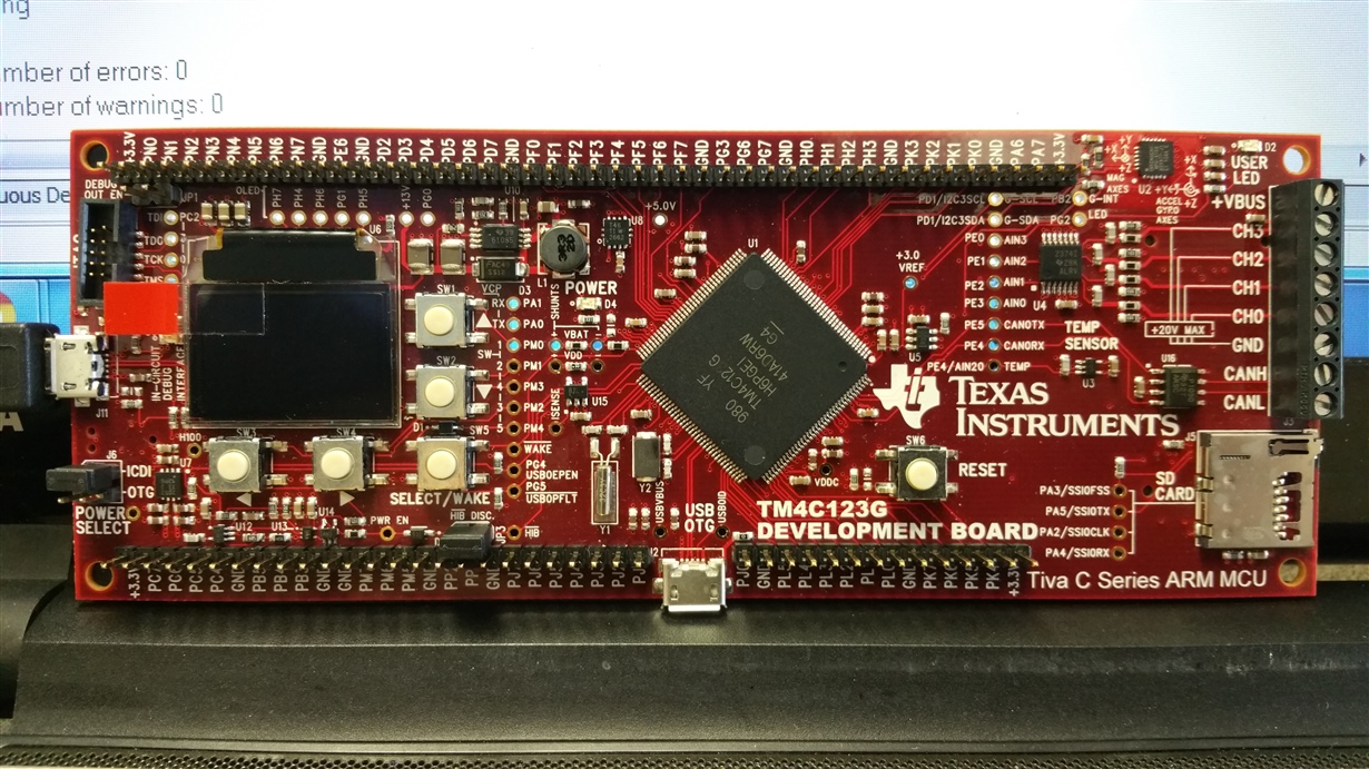

I am seeking verification of a possible manufacturer's defect to allow for the acceptance of a Mouser RMA request. The following details the problem:
At the point of failure the device was connected to a computer via the IDCI USB connector and was recently programmed. Said program was actively running with no extra hardware attached to the device. During the program's operation, the device power indicator LED shut off and the device was no longer operational -- I suspect that the power regulator on the device may have failed. There was no physical interaction with the device for 30 seconds before failure, which leads me to believe that the board may have had a defect. Moreover, none of the typical odors due to component failure were evident on failure.
I connected to the board to another computer to test whether it was my computer that had the issue and found that the device debug communications port can be seen and correctly identified from the Windows device manager as "TI Stellaris (COMxx)" but the device still does not receive power to the rest of the circuit.
I did not attempt probing the device to test which exactly which component has failed nor have I inspected the manufacturer solder joints.
The program loaded onto the board that failed was later tested on another board and the program was found to be functional.
The program utilized interrupt-driven UART communications via the IDCI port (UART0),  interrupt-driven button press identification (ALL_BUTTONS), and an interrupt-driven comparator implementation (COMP0). The hardware necessary to test or utilize the comparator was not connected at the point of failure.
If you need any more information, I would be happy to provide it.

    One thing to clarify from my end, you mentioned you can see the Stellaris Debug port in the Device Manager still right? When you try and debug in CCS, does it not recognize a valid device for programming? Also just in case it's needed so I can try and keep this streamlined, a picture of the EVM in which all jumpers can be seen would be good as well.
  • Jonathan Strang said:
    ...the device debug communications port can be seen and correctly identified from the Windows device manager as "TI Stellaris (COMxx)" but the device still does not receive power to the rest of the circuit.
    It is suspected that,  "for the device debug port to be seen" - the MCU serving as ICDI - must be powered.       And that power would seem "odd" to be uniquely routed to the ICDI MCU - alone - don't you agree?     I'd resolve that (apparent) conflict - prior to moving forward.

  • Good morning Ralph,
    I have provided the images requested with the debug output for IAR provided instead of the debug output for CCS. I provided the picture with IAR as that is the environment that I am required to use. If preferable, I can recapture these images with CCS.
    The following image is a close-up of the DK-TM4C123G Plugged in to a computer:
    The following image shows the Windows Device Manager window, the IAR flash attempt output, and the DK-TM4C123G board:

    From what I have gathered, TI handles return processes for boards shipped through our TI.com eStore. Not for other distributors. That Mouser is requesting TI to look into this has not come up before.
    I would ask you to do one more test with the DK board. Use our LMFlash Programmer software and try to do a Debug Port Unlock for your board. If it doesn't succeed in recovering your board, then go ahead and push them to finish the RMA. We aren't going to spend more engineering time on our end just to meet their own RMA requirements. Show them this post (and your proof of trying the LMFlash Programmer step) if needed.

  • Hello Ralph,
    I did try the Debug Port Unlock process with the provided copy of the LMFlash Programmer as included with the DK. The program had reported that the procedure was successfully completed but there was no perceivable change in the DK's state of usability.
    Unfortunately, I am no longer in possession of the DK in question as Mouser decided to proceed with the RMA exchange.
