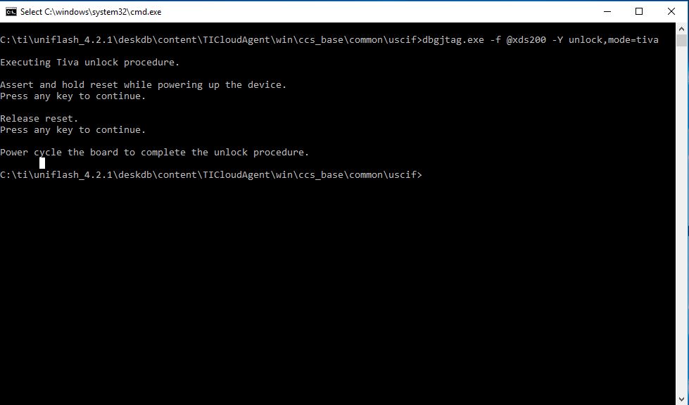

Team,
How can the mass erase function specifically be called from the CLI generated by the UNIflash tool? Any input welcomed.
Chris

Hi Chris,
You haven't answered my question about what debug probe the customer has. If XDS100 or XDS200 is available then the customer can use the dbgjtag.exe to unlock the device as described in the app note I pointed to. See below screenshot. With that said, a bricked device is normally associated with some destructive code running. The customer should investigate what was the code prior to the lockout so the same problem does not repeat again.
