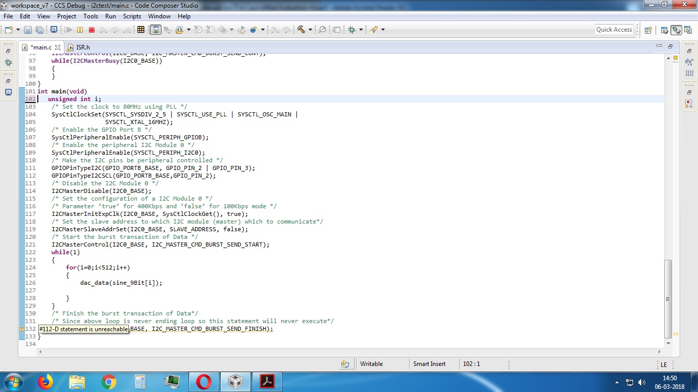

have interfaced mcp4725 DAC with tiva to convert digital input(0 to 4096) to analog value(0-3.3,because vcc of DAC is connected to +3.3V).the following error (#112-D statement is unreachable) appears near the last code line[ I2CMasterControl(I2C0_BASE, I2C_MASTER_CMD_BURST_SEND_FINISH);] and can the same command be used to send single value instead of sending multiple value in loop like in below program?
the Output of DAC is coming 1.64 V constantly for the program below

int main(void)
    unsigned int i;
    /* Set the clock to 80MHz using PLL */
    SysCtlClockSet(SYSCTL_SYSDIV_2_5 | SYSCTL_USE_PLL | SYSCTL_OSC_MAIN |
                   SYSCTL_XTAL_16MHZ);
    /* Enable the GPIO Port B */
    SysCtlPeripheralEnable(SYSCTL_PERIPH_GPIOB);
    /* Enable the peripheral I2C Module 0 */
    SysCtlPeripheralEnable(SYSCTL_PERIPH_I2C0);
    /* Make the I2C pins be peripheral controlled */
    GPIOPinTypeI2C(GPIO_PORTB_BASE, GPIO_PIN_2 | GPIO_PIN_3);
    GPIOPinTypeI2CSCL(GPIO_PORTB_BASE,GPIO_PIN_2);
    /* Disable the I2C Module 0 */
    I2CMasterDisable(I2C0_BASE);
    /* Set the configuration of a I2C Module 0 */
    /* Parameter ’true’ for 400Kbps and ’false’ for 100Kbps mode */
    I2CMasterInitExpClk(I2C0_BASE, SysCtlClockGet(), true);
    /* Set the slave address to which I2C module (master) which to communicate*/
    I2CMasterSlaveAddrSet(I2C0_BASE, SLAVE_ADDRESS, false);
    /* Start the burst transaction of Data */
    I2CMasterControl(I2C0_BASE, I2C_MASTER_CMD_BURST_SEND_START);
        for(i=0;i<512;i++)
            dac_data(sine_9Bit[i]);
    /* Finish the burst transaction of Data*/
    /* Since above loop is never ending loop so this statement will never execute*/
  • Hi Siva,
    You screenshot is not the same as the code you posted. In your screenshot the I2CMasterControl(I2C0_BASE,
    I2C_MASTER_CMD_BURST_SEND_FINISH) outside of the while(1) loop and hence never reached.
    What do you mean the loop is never ending? Are you getting stuck in the line while(I2CMasterBusy(I2C0_BASE))? Can you try the below and see if it makes a difference.
    while( I2CMasterBusy(I2C0_BASE) );
    with
    while(!( I2CMasterBusy(I2C0_BASE)));
  • Statement is unreachable because of preceding while (1) loop.
