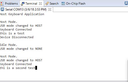

     Have you had a chance to try the TivaWare  usb_host_keyboard example? I just tried it and plug->unplug->plug the keyboard and the host is able to detect when plug or unplug happened. Please see below. I hope the example will be a good reference for your bardcode reader application.
