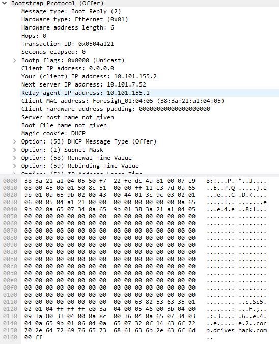

    I have attached a wireshark capture from the customer.  The micro-controller currently goes into Auto-IP mode when link loss is detected and you can see that the micro-controller is sending DHCP Discover from 169.254.4.5 IP address.  The network sees the request and responds with DHCP Offer.  However, the micro-controller does not take the offer and continues to send DHCP Discovers.  One thing I am planning to try is to disable the auto-IP so that the micro-controller does not get the 169.254.4.5 address.  Not sure if that is preventing it from seeing the DHCP offer.

  • I would expect a DHCP discover datagram to have 0.0.0.0 as the source address. Odd.
  • Do the MAC address look correct? The OID is the IEEE Registration Authority and the DHCP offer is going to a different IP than the discovery source.

  • The MAC address of the micro-controller is correct. If you notice, the last 2 bytes of the IP address is the same as the last 2 bytes of the MAC. When the micro-controller does not get a valid DHCP response after a period of time, the micro-controller reverts to APIPA and picks an IP address for itself. We specifically used the last 2 bytes of the MAC address to be the 2 LSBs in the initial APIPA IP address to avoid IP conflicts. That explains why the micro-controller is using the 169.254.4.5 IP address. This indicates to me that at the time the capture was taken, the micro-controller has failed to DHCP for some time and has reverted to APIPA. While in APIPA, the micro-controller still sends out DHCP requests periodically.

     It seems like in the BootP payload of DHCP Offer frame , the client is sending the IP address of 0.0.0.0 but the server is trying to lease a new IP address of 10.101.155.2. I don't know if the client is refusing to take this new address but rather keeping the prior one and hence not sending the DHCP request phase.

    Why is the subnet mask in the offer 255.255.255.254? Normally private network IP that starts with 10. has a mask of 255.0.0.0. I tried starting server with this mask and it failed to load.

    Looking at the CAMERA25.pcap (bad) and CAMERA25_good.pcap files I can't see any differences in the DHCP Offer messages from the DHCP server between the good and bad cases.

    We found that when we disable APIPA (auto-IP) on our device, the issue went away. There is a switch between the device and the router. I am suspecting that when the device gets into AUTO-IP state, the switch no longer forwards DHCP Offers to the device. I would say the issue is resolved now. Thank you all for your help.
