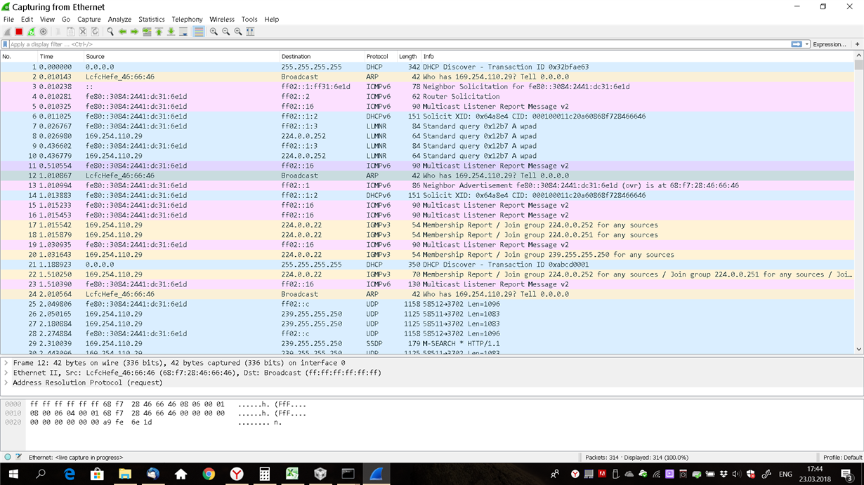

Ok. i changed enet lwip example: just transmit message. I do not get anything on port 7070 Where I'm wrong? I selected my inserts
nt

Can you try with DHCP first before you use AUTOIP?
-Done. Nothink changed. I get IP-adress 169.254.159.146. Network is configured for 169.254.159.1 mask 255.255.0.0
#define LWIP_DHCP 1 #define LWIP_AUTOIP 1
struct udp_pcb *pcb; pcb = udp_new();
