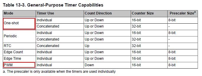

    Let's review basic Timer operation & capability:
    The chart above reveals that when placed w/in PWM Mode - your "Individual timer" supplies 16-bit count capacity - plus an additional 8-bit - prescale capacity.      Should that WIDE capacity NOT provide,  "All the fine control/granularity" - one could require?
    Is it not (more than) likely - that your "math efforts" - for instance any required (intermediate/final) result "scaling" - proved limited (or mistaken) - and thus there existed,  "No REAL requirement to deploy Floating Point?"     I'd place a "tall chip-stack" on a Vegas table - to place that bet.
    Had you revealed the key elements of your code - which describe how you perform temperature measurement - and (properly drive your fan(s)) - those here would have - almost surely - been able to suggest "NON Floating Point Methods" - to (even) better achieve your goals.
    And note too - your Control Code (as shown, w/in 24 Mar, 08:55 post ,above) merely compares, "Hi-Side FET temp vs. Lo-Side FET temp" - apparently with NO CONSIDERATION to (any) OVER-TEMPERATURE Recognition!     Such cannot be right - can it?

    Scaling is only necessary to extend GPTM counts from 12 bits up to 24 bits when very high numbers must be processed in excess of a 12 bit binary value (0xFFF). Scaling would infer higher frequency in excess of 25kHz, e.g. GPTM with 120Mhz SYSCLK time base and (0xFFF) load value would produce a frequency of 29.304khz.
    Point is the GPTM seemingly is not cable to match any FP integers in the 1's position relative to match count updates loaded on the next cycle, It won't load them!

  • It REMAINS ... CERTAIN - that the 24-bit, PWM Capacity (under Timer Mode) should be "MORE THAN CAPABLE" to enable EXACTING CONTROL - and avoid the "challenge" and extra MCU Resources - induced via Floating Point.
    You are "silent" w.r.t. your code revealing the REQUIRED, "Test for Over-Heating" - your code (simply) tests for "Hi-Side vs Lo-Side" Temperature - which is GROSSLY INSUFFICIENT!

  • Actually believe they are one and the same topic since it seems the GPTM can not properly match counts from the decimal values 1's position being calculated by the FPU. That value is derived from ADC samples that were divided and filtered too by the FPU. That was the entire point of the Post not that the FPU is not specifically working, rather the results for the FPU don't seem work in the GPTM and later finding in this post "No matter how the FPU processes the decimal point positions or adds place holders."
    I have tried to iterate several times the GPTM is only matching load counts for 10's & 100's decimal position but not the 1's no mater how the FPU is queried for division. That GPTM behavior seems more like decade counter (base 10) to me having spent many hours with chaining several together and de-multiplexing the counts.
    Don't have any more time to debate this FPU issue and the GPTM works with 10 speed steps being ok for now.
  • You must have missed 25Khz several times and posts back or have not ever had to control digital fan speed via PWM. Again scaling the GPTM to 24 bits unequivocally will not work to produce 25kHz from CCP0 PWM and requires 40us period to generate 25Khz wave shape at all times. The fan speed is controlled by interrupted updates to the match count load value to control the PWM duty cycle around 25Khz.
    Fail to see how 140ms can keep the frequency constant perhaps you can show us this math or give up on the scale idea. Believe when I say the GPTM ain't matching duty cycle to the 1's digit position no matter the FPU value produce as a match count load.
    Would it not seem odd GPTM only loads match counts (above posted code) that fall on a temperatures 10's position (*C), e.g. 310,320,330,340 etc. but not 311,312,313,314 nor 321- 329, 331-339, 341-349 yet 350 is valid so is 360,370,380,1000 these are not 24 bit integers or decimal values. Those value above (decimal point) added are actually 31.1, 31.2, 31.3 etc. and by dividing integer representing a decimal value in a text box, e.g. value (311/10) gives us 31.1*C as the digital readout. In the real world that is a decimal value produced by an binary integer passing through the FPU, seemingly adding precision to the 1's/10's/100/'s place holder depending on the integer input to the FPU.
  • "Better check 24bit math twice as 25Khz PWM frequency can not be represented by 24 bit load count values with 120Mhz SYCLK time base"
    Unless you live in a different universe, a 25khz pwm requires no more than 13 bits to represent on a 120Mhz system.

    Yet neither CB1 or yourself can answer why the GPTM can not load (ALL) concatenated (int32_t) values derived from the FPU. That alone leaves little question in my mind an intent of demeaning sarcasm exists.

    Seemingly may be wrong in that idea as the (float in32_t) type does produce floating decimal points in CCS debug variable view and the (int32_t) variable define after a divide, e.g (N/10) does produce floating decimal point in the GUI display data. The last part N/10 is working quite well with (int32_t) defined variables as pre-processed (N/10) value loaded into a text box of a widget.
    You are correct that the IEEE FPU binary precision (float) type may have limitations of precision as it seems to round off the value to the nearest -1's or 10'ths position. That seems to define "single point precision" only possible, e.g 2.0-9 are all that can be factored other than floating the decimal point to the right as the value grows beyond the 1's digit place holder.
