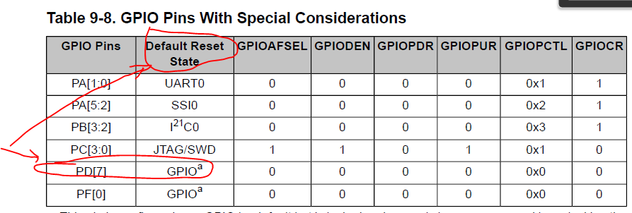

Hi all, I am seeing different behavior between PD6 and PD7 on DK-TM4C123G launcher pad and hopefully someone can shed some light on why. I am running the code attached to this post which is really the blinky example project without some minor modification, when I use PD6 as the GPIO pin, I can see that its output toggles between HIGH and LOW when the code runs, however when I change the GPIO pin to PD7, its output always stay at LOW, why?

  • It appears that you've "yet to note" that PD7 "defaults" into an "NMI Input" mode.     (one of two pins which does such)
    To  "rescue/remove"  PD7 from that (most often) unwanted fate - you must first "Unlock it."     Forum Search box - atop this page - details the "how to unlock" process.
    Once unlocked - your normal "GPIO as output" methods will (magically) restore PD7 to order...
    Should you (or others) be wondering - PD7's "Partner in unwanted crime is PF0" - which requires similar "unlocking."

  • Thanks for the quick response Cb1! As you can see from the attached code, I configure PD6 and PD7 in the identical way, I just changed TEST_GPIO_PIN  macro to GPIO_PIN_7 or GPIO_PIN_6 for testing. I have thought about the default configuration of the pin PD7 might not be GPIO, however the datasheet of TM4C123G clearly states that it is a GPIO pin by default, please see table 9-8 on page 599 .

  • Hello Richard,
    cb1 is mostly right though, regarding the unlock comments.
    See the following comment from the datasheet regarding the 'a' next to PD[7]:
    • a. This pin is configured as a GPIO by default but is locked and can only be reprogrammed by unlocking the pin in the GPIOLOCK register and uncommitting it by setting the GPIOCR register.
    This is where your issue lays, so you do need to follow the steps outlined in this posting: https://e2e.ti.com/support/microcontrollers/tiva_arm/f/908/t/374640
  • Hi Cb1, you are correct on "Once unlocked - your normal "GPIO as output" methods will (magically) restore PD7 to order...", I unlocked PD7 before calling GPIOPinTypeGPIOOutput (), now PD7 works as PD6!
