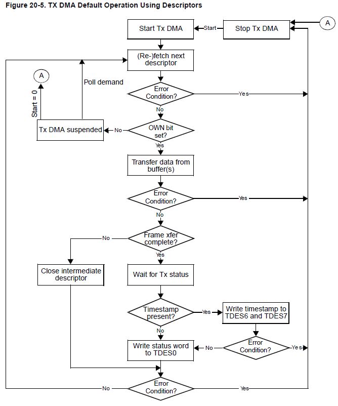

1. For logic testing purposes, How can I simulate EMAC_INT_TX_STOPPED, EMAC_INT_RX_STOPPED? Other errors?
2. When error occurs on a given TX descriptor, will the EMAC continue to the next descriptor?
3. When error occurs on a given TX descriptor, will the EMAC reset that DES0_TX_CTRL_OWN?
     The EMAC DMA will stop when detecting an error. Please see below flowchart depicted in the datasheet.
       I think that when INT_TX_STOPPED bit is set, it is due to errors. This means you may see multiple bits set at the same time. The errors can be due to any of the below listed events in the datasheet. You will need to create one of the below listed errors to simulate the error event. If you properly configure the EMAC using the TivaWare and have the TCP/IP stack, I kind of doubt that you will can easily run into any error events. What you can try to do is by overwriting the EMAC configuration such as the data buffer pointer address with an incorrect/invalid address in the descriptor to see if you can create a bus error. In this case, hopefully the DMA will stop when a bus error is detected.
    No, Not according to the flowchart.
    I'm not 100% sure. The OWN bit is set by the CPU and cleared by the EMAC DMA in a normal operation. If the DMA detects an error, the Ethernet operation is suspended and error is generated to the CPU. The CPU will need to diagnose the error source and it is CPU who can re-setup the descriptors and set the OWN bit for DMA again.
