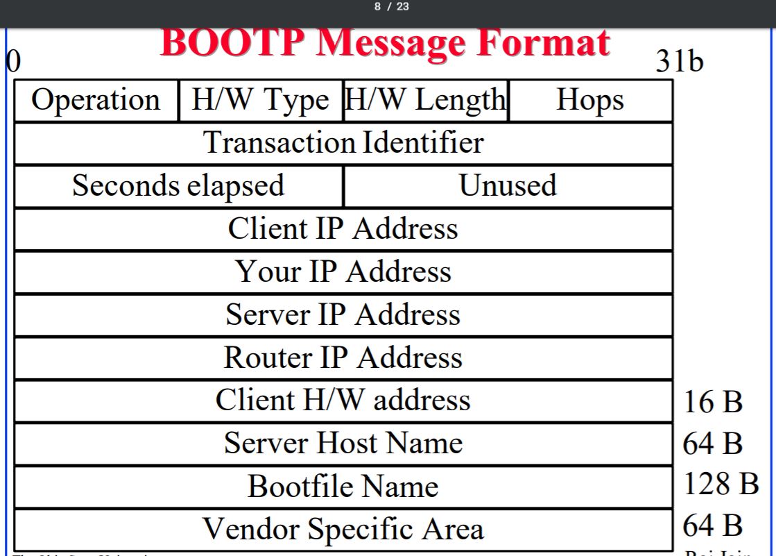

    In the TivaWare example, the application will call the update routine in the bootloader (boot_emac_flash) to start a new update. What you can try to do is to build some intelligence into the bootloader such as that at the end of a successful update an unique key (i.e. 0x12345678) is written to a predefined address in the flash memory.  If the update fails in the middle then that unique key location will still be in an erased state. The bootloader will not only check if the new application has valid stack pointer and the reset vector but also this unique key location. If the unique key location is not written then the bootloader will force an update again for image A. I think in the BOOTP packet request, you can specify the corresponding bin file name. See the boot filename field in the BootP message format. However, I think you need to have the BootP server to decode the boot filename field so the bootP server knows which application image to update. I don't think LM flash programmer supports that today.
