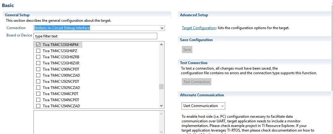

     Which TivaWare version are you using? Please install the latest TivaWare library from . Once installed, you can import the qs-rgb example from <TivaWare_Installation>/examples/boards/ek-tm4c123gxl/qs-rgb. The example comes with the target configuration.
    If you want to create your own target configuration like below.
    1. Go to File->New->Target Configuration File.
    2. See below diagram.

  • Hello again,
    I uninstalled everything, and installed CCS v8 with Stellaris In-Circuit Debug Interface checked at installation and it works. That said, I had to recreate another Target file (I don't know why), but it works well now. EDIT: taget_config.ccxml need to be set as "Active/Default" because it is not set automaticaly during import.
    In my previous install I didn't installed the Stellaris In-Circuit Debug Interface at installation because I used only XDS100 from CC1310 launchpad board. Maybe there is a good way to install new probe on an "old" installation, but I didn't found how to do this without uninstall CCS and install it again.
